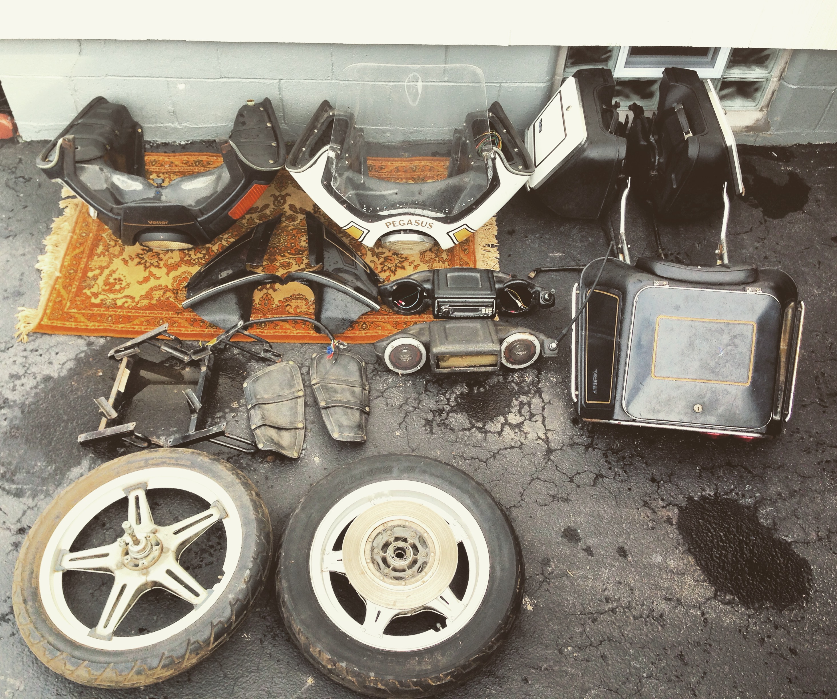

    Ok Guys...
    I hit the mother load this morning. I tagged along with a friend to a craigslist ad for a 1986 Yamaha Venture. My buddy ended up buying the bike and when we were about to leave I was bullshitting with the seller about the 1979 GL1000 project I have and how I just put a Windjammer SS on. He said he had some Vetter stuff up in the attic of his barn, so for the hell of it we went and looked. He had 2 Windjammers with brackets, lowers, and cycle sounds. He also had a full set of luggage with brackets, and a spare set of wheels for my GL. I was getting pretty excited, then he told me how much he would take for all of it.... $100 later I was loading the haul into the back of my truck.
    I got all the stuff back to my garage this morning, cleaned it, and started to mock some of the luggage onto my bike. It looks like the brackets for the side bags are not the correct brackets for the GL1000, I may be able to modify them to work for me, but they are definitely not right. Everything seems to be in great shape. I'll have to replace the locks on all the bags as the previous owner never had the keys for any of them, but that doesn't seem like a big deal.
    So for the question. Is there any way to identify what bike the brackets I have were meant for? And does anyone have a set of GL1000 brackets they would be willing to sell or trade for?

    That's a nice haul! Hard to say what bike the bag brackets would be for, but it doesn't take much to modify them to make them fit any bike. There weren't many, if any, for a 1200 GoldWing when I was looking, so I modified the only ones I had... yeah, GL1000.

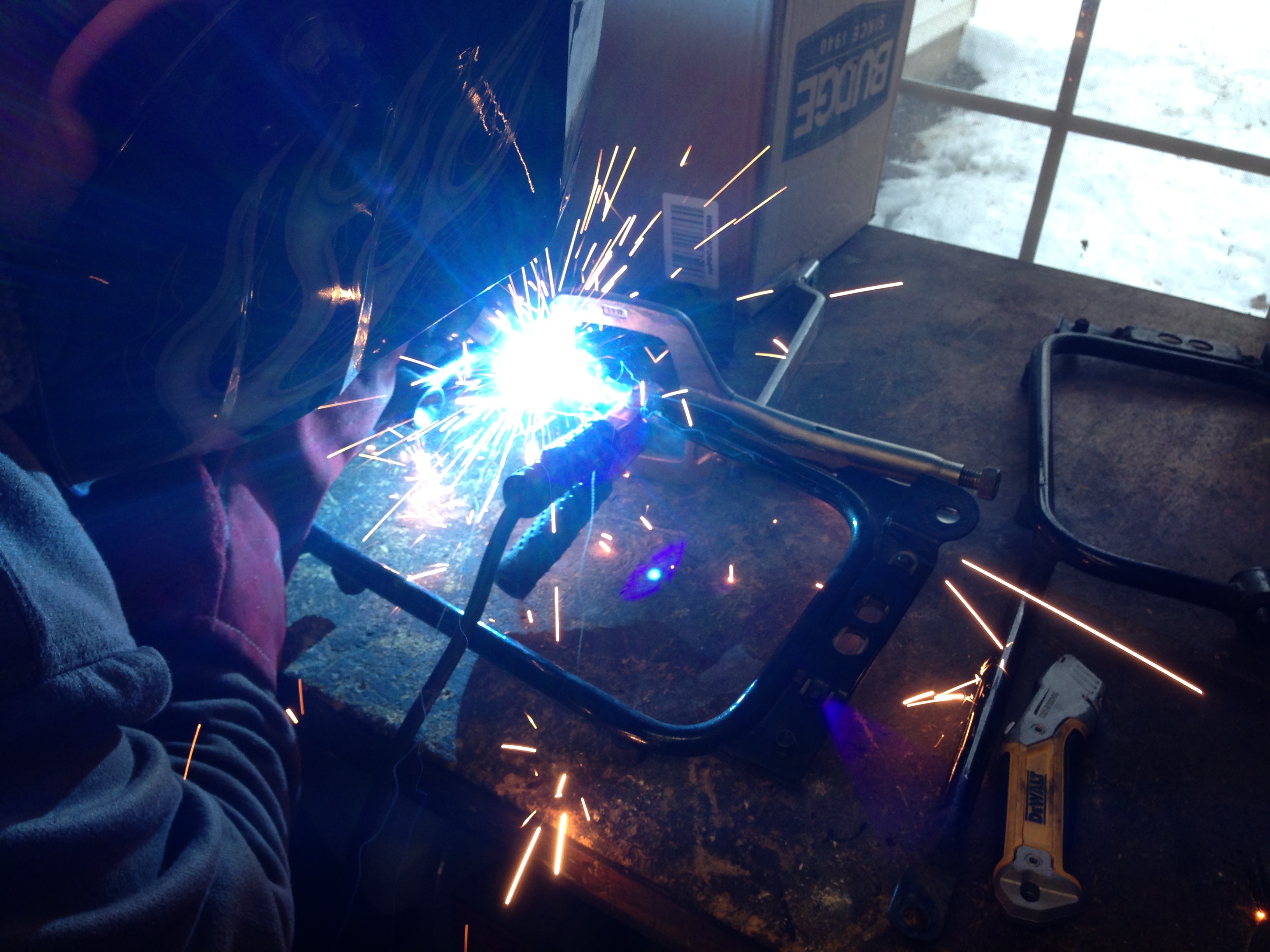

    Thanks for the info, I figured that was the case. I didn't even wait for a reply. There weren't any eBay so I knew I was stuck with what I had. So I compared the brackets I had to the ones that are in the GL1000 installation guide and went to fabricating.

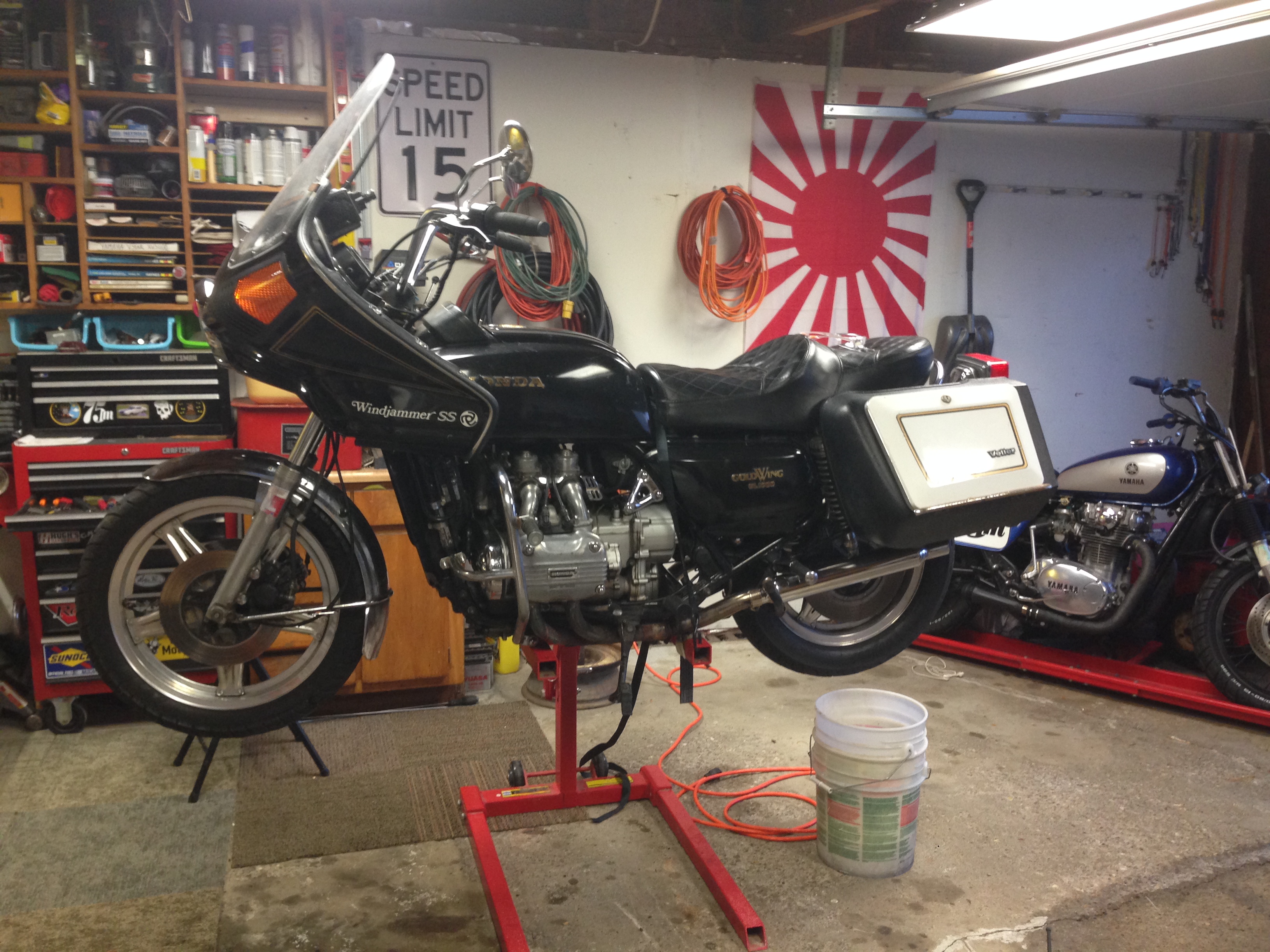

    Looking closer at the front wheel, I have 'NEVER' seen whatever these are on the wheel.
    Check if a magnet will stick to the spokes. If NOT, I would not use that wheel as it was recalled. I only say this because it's something I haven't seen before and I'm curious if it's an identifying feature in addition to the magnet test.

    OK, I didn't know anything about that! So the wheel in the picture above, the spokes are steel. The little things you circled appear to be plastic covers that say Honda. With that being said the wheels that are currently on my GL1000 are both completely aluminum.

    OK, I've just never seen those plastic covers.
    The recall ONLY affected the 1978 front wheel. They redesigned the spokes for 1979 and went back to aluminum. So...1978 front has steel spokes. 1978 rear, 1979 front, and 1979 rear have aluminum spokes.

    Cool. The spares I bought I believe we're off a 1978 now that you mention it. The front is steel and rear is aluminum.

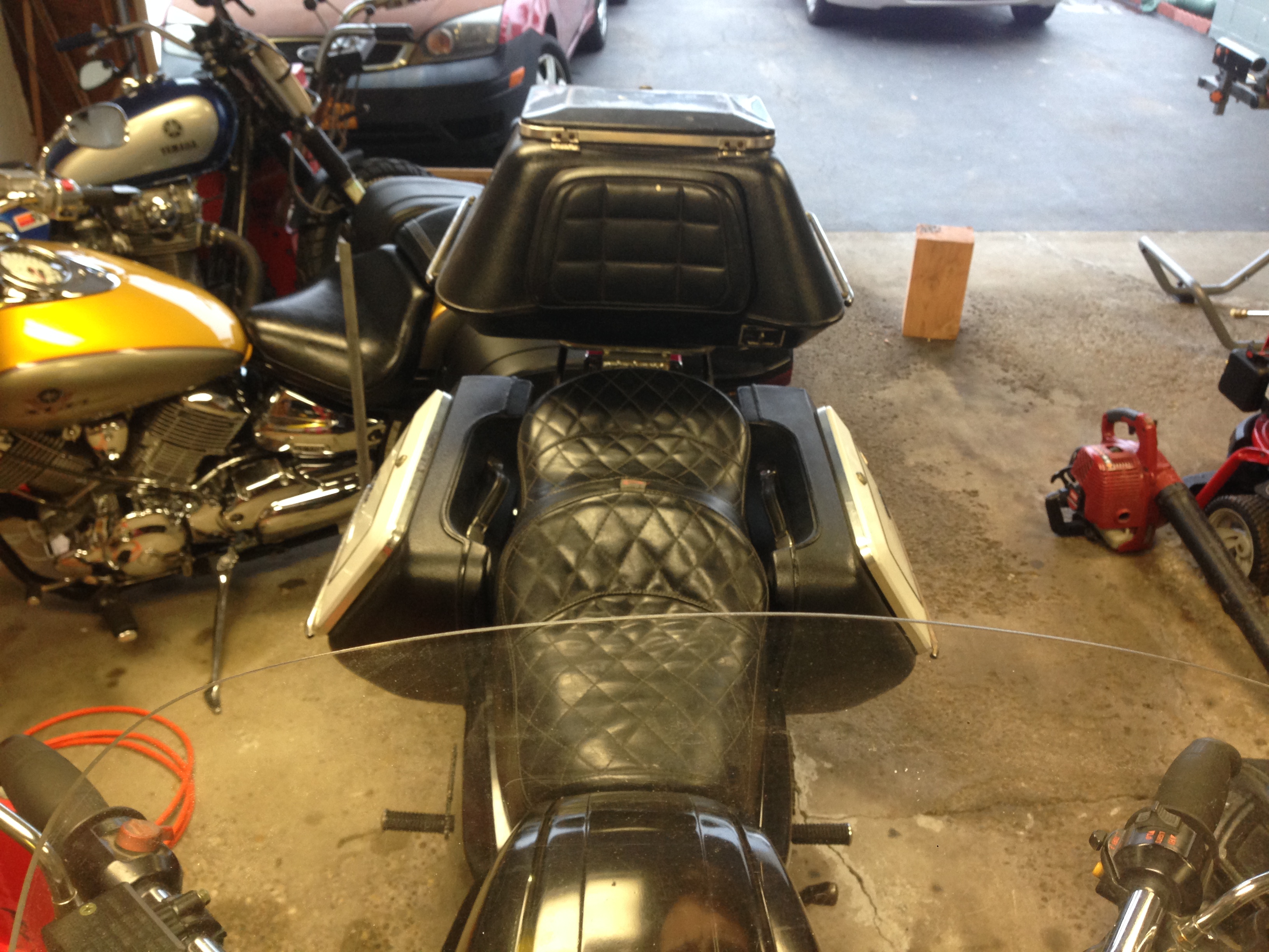

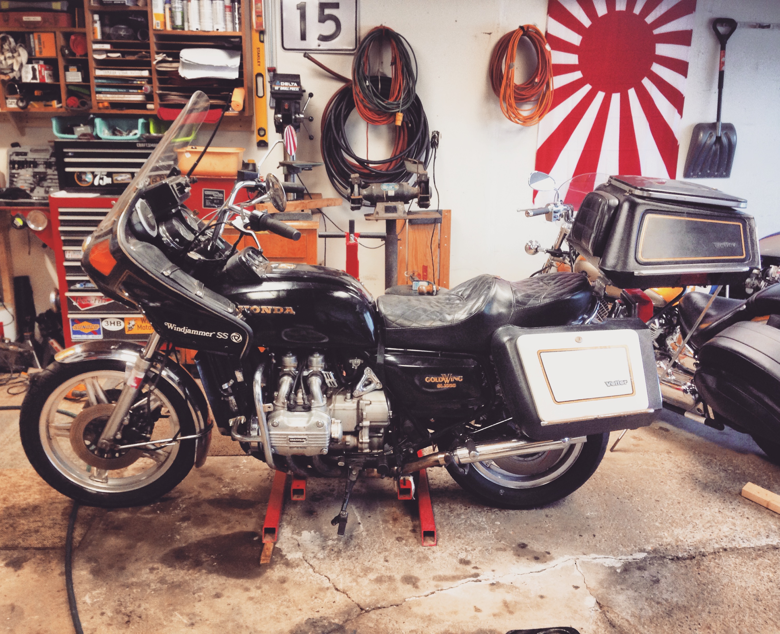

    The white luggage is growing on me too! I was going to pull all the covers and paint them black, but I may leave them now. The only problem now, is the white paint is in rough shape, I may be able to shine them back up but I'm not holding my breath.
    I got the mounts all made & modified to fit my bike. Now all I need to do is replace the tail lights on the trunk; unfortunately I am missing one of the round lights.

    The trunk is definitely a vetter trunk too. The previous owner just took the hole sissy bar off of the donor bike and left it all attached. The brackets that held all the luggage and racks to the bike were definitely from another variety of motorcycle, but after a little cutting and welding, we're in business. See above photos.

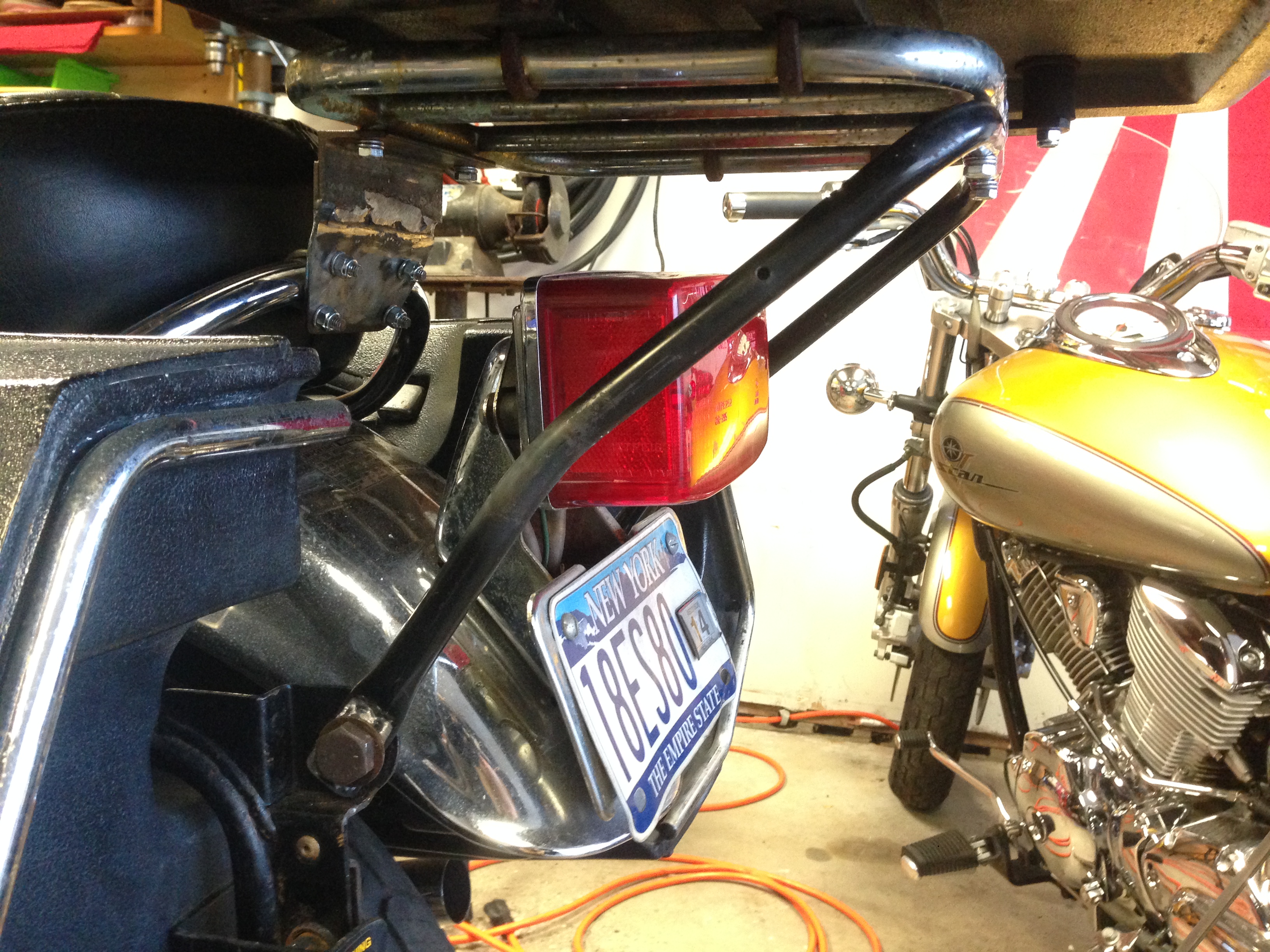

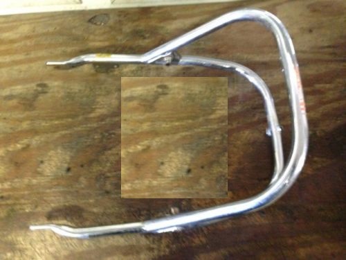

    Yes a Vetter trunk. I was trying to identify the mount and all I could see in the pic was chrome bits sticking from under the trunk. No Vetter mounts were chrome, AFAIK. I suspect, again guessing as I can't see it, the chrome part looked something like this (Honda calls it BUMPER, REAR) from a GL1100. s-l500.jpg
    Which lights do you have? No pic of them so I can't see.
    http://www.vetterowners.com/threads/trunk-tails.982/#post-7286
    I don't have any more spares of the 'older' style, but have some of the 'newer' style.

    You're correct. The chrome piece that I took off the trunk rack that came with it is exactly what you have linked above. I made my own riser that clamps to my stock GL1000 bumper.
    As for pictures of the tail lights, I don't have that shows the lights all that well. I have attached a couple below that roughly show them.
    Edit: I am only missing one tail light. The other missing light was in the trunk.

    Looks like you have the newer style (plastic) light assemblies. I have 4 from a trunk that the bottom is busted out around the mounting holes to the rack. I just pulled the lights and the bases on all 4 have cracks in the plastic. Nothing broken off, but I'm not impressed with their 'light assembly' selection. Then again they are ~40yo.:confused:
    Nothing as bad as this post (pop rivets will still hold them on) http://www.vetterowners.com/threads/my-trunk-arrived-fixed-broken-light-brackets.919/#post-6690 and when the lens is on, none of the cracks are visible.
