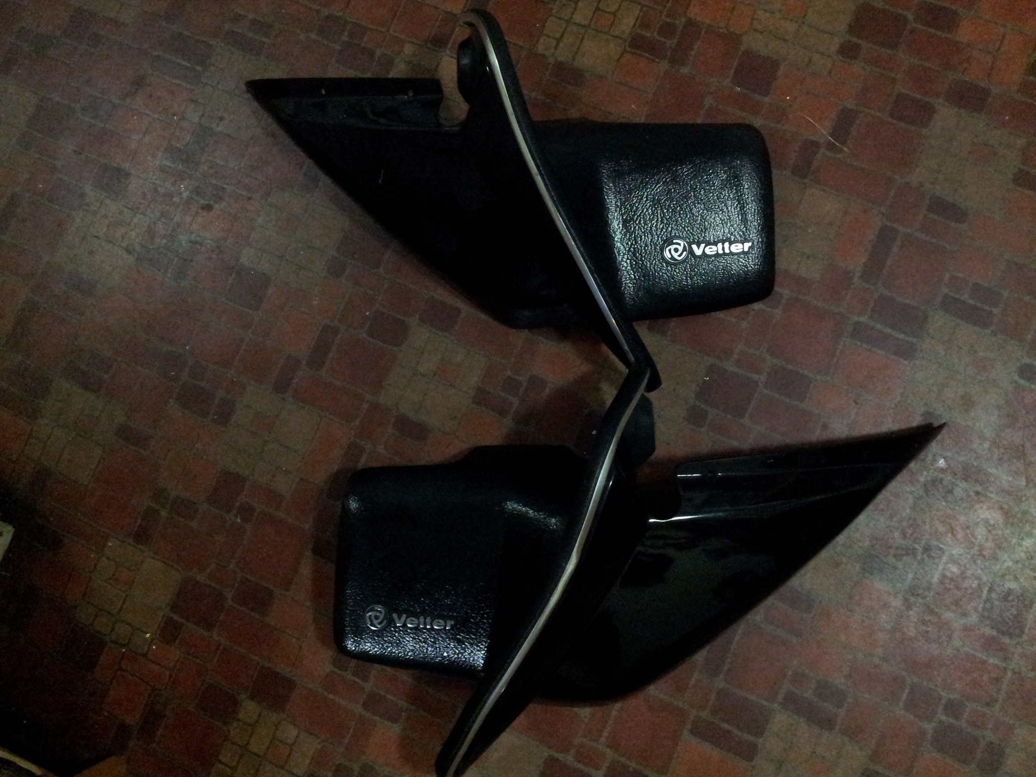

    My fairing lowers are designed for a Kawasaki KZ900- KZ1000 but according to the Vetter application pages they should fit my GS1000G. They sorta do- but they will definitely need some work done first. Also, I don't really like the textured plastic piece that covers the carbs and restricts cooling air flow to the cylinder heads so I want to cut that off too.
    The only tool that I can think of to make the cut is a Dremil drill with a small diameter wheel. Even at that, I'm not too confident that I can make a nice looking continuous curved cut, so I'll try an inch out from my final cut and take it from there.
    I guess I could also use a file and some sandpaper on the final edge.
    Any help would be appreciated.

  3. Mickeymoe
    Mickeymoe Grasshopper
    Jun 17, 2017
    22
    Hey Brian,
    They are purportedly "Type 3", for Vetter 4. I would gladly trade for a pair of known correct ones (assuming these are not) for my '80 Suzuki GS10000G. The lowers I had on my '80GS850G had no side extentions but I may have bought them after they were modified. Here's a crappy picture, can take better ones. There's a pair of "3s" on Ebay but the guy wants 175.00 + 12 bucks shipping and they are the wrong color. But again, these may be uncut "3s" anyway, thus my post about how to cut them and what tool to use...

    Hi, I used a jig saw with a fine metal blade and it made a nice cut. I was surprised at just how smooth the cut was. Mike

    Yea Mike, the stuff cuts pretty easily. I used a Dremil tool with a cuttoff wheel at the highest speed. It did a nice cut and the edges the melted just broke right off at the cut line. I little working with a file and sandpaper, followed by a black paint pen and they look factory!
