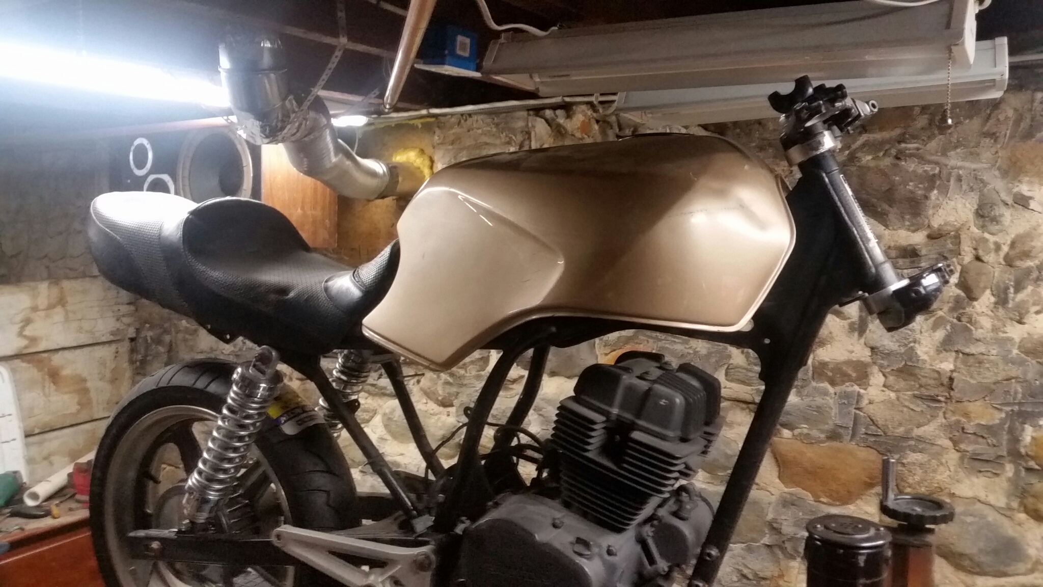

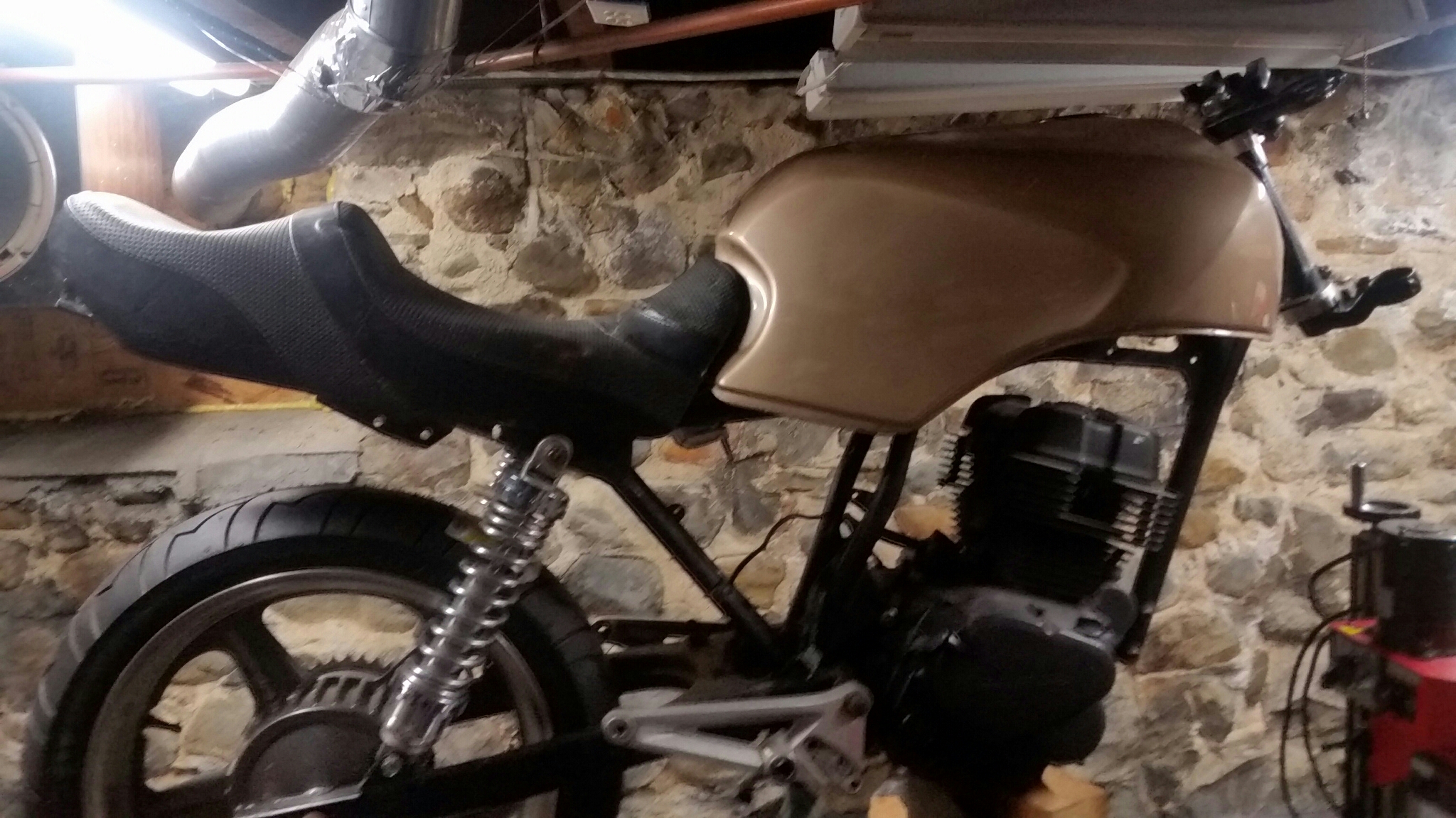

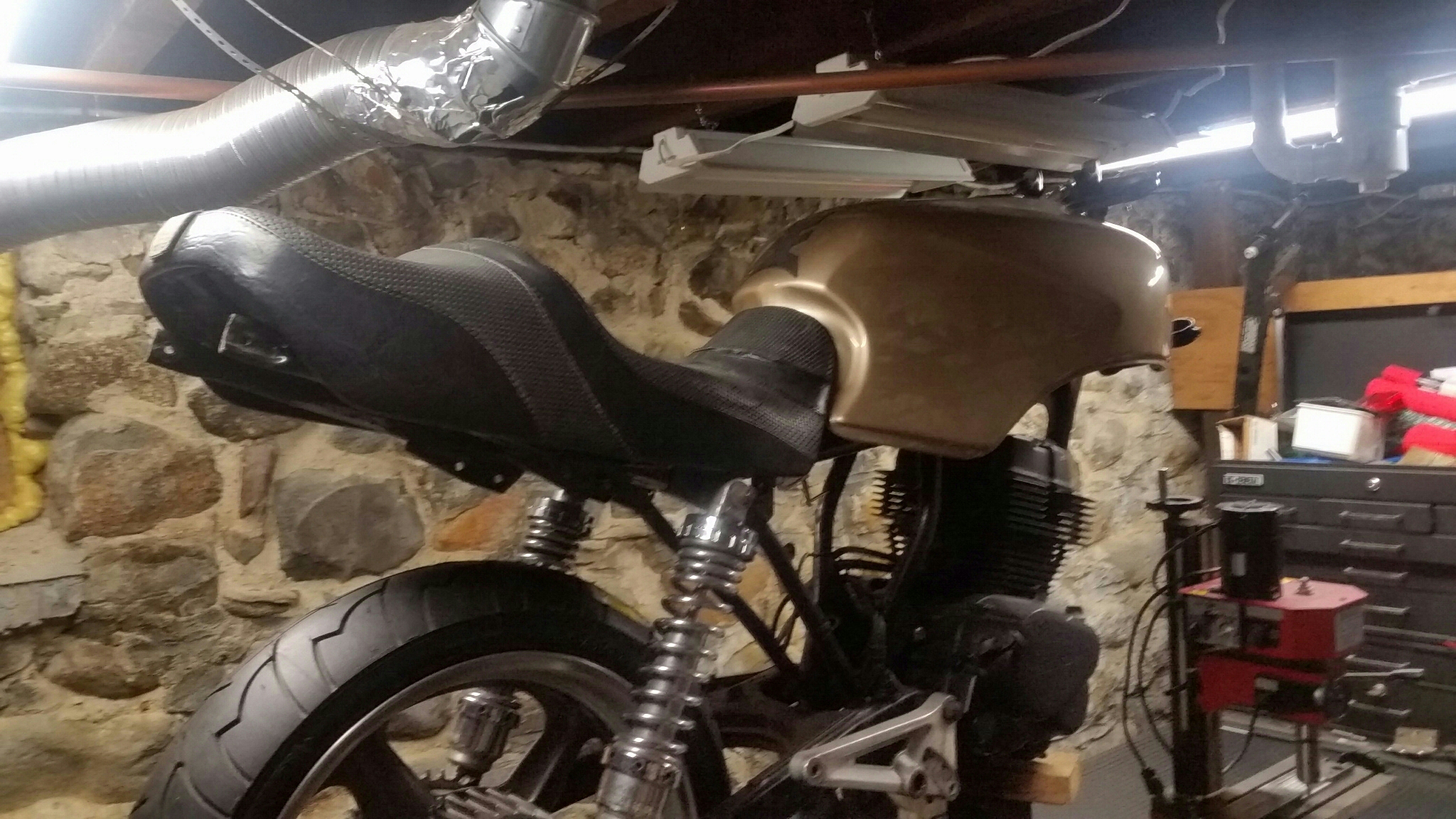

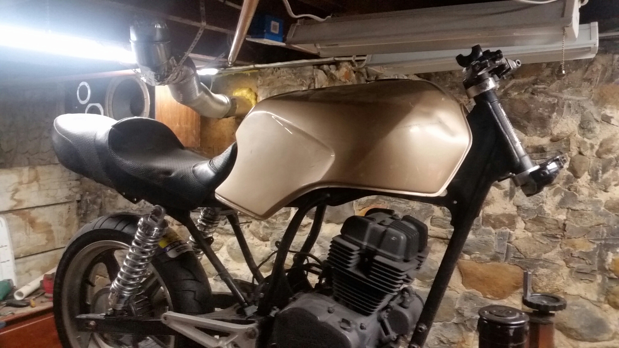

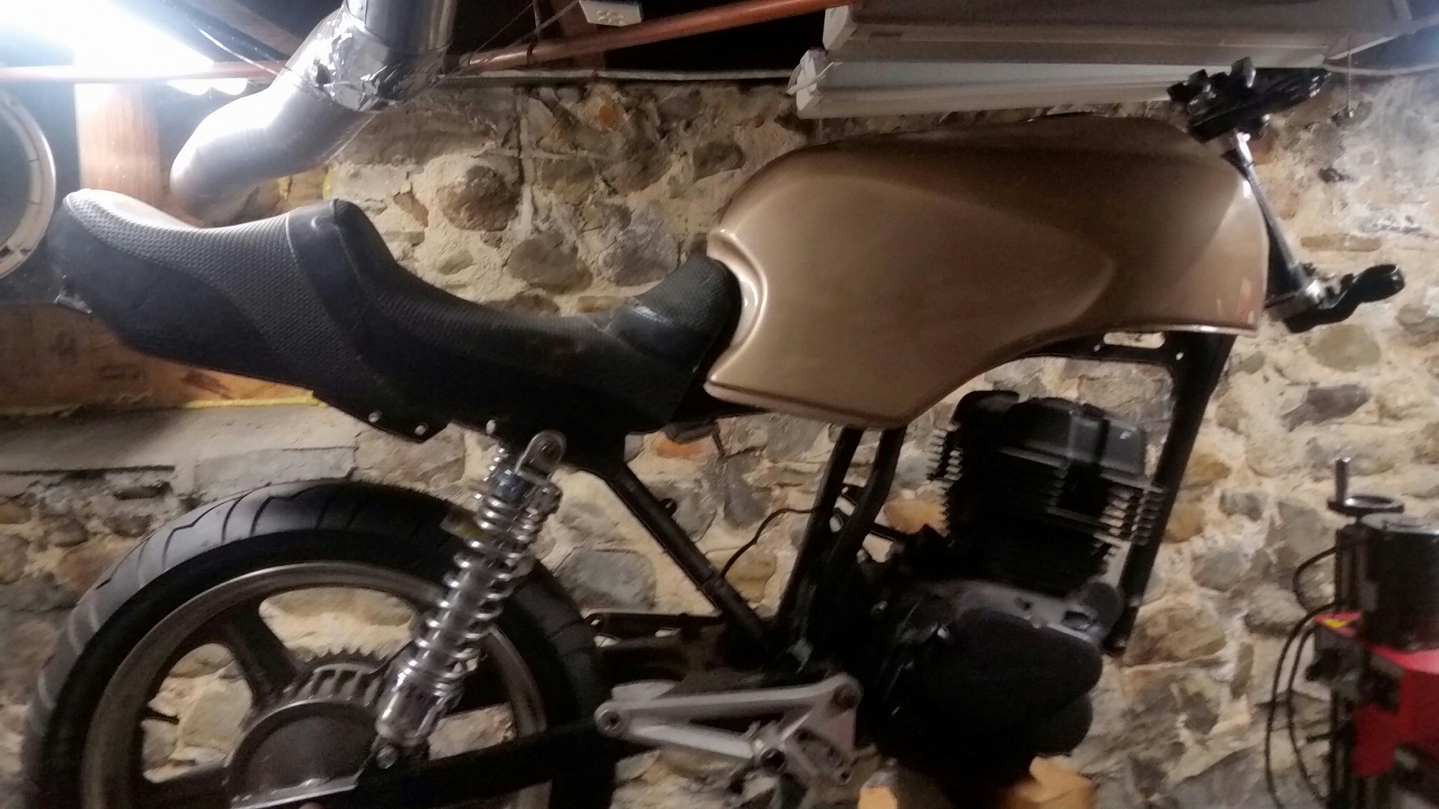

I had some time to mock up the tank and seat on a 250 Nighthawk I'm building.
The front mounts for the Concours tank are a full 2.6 inches wider on each side than the Nighthawk's tank mounts, and the tank sits quite a bit higher on the frame than the stock tank does. The rear tank mount will be easily adapted with a simple adaptor plate, for the front mounts I'll probably fab up a one piece horse shoe shaped adaptor that sits over the top of the frame and clamps to the stock mount pegs for stability.

Good luck with the build. Looking forward to the Vetter fit up!

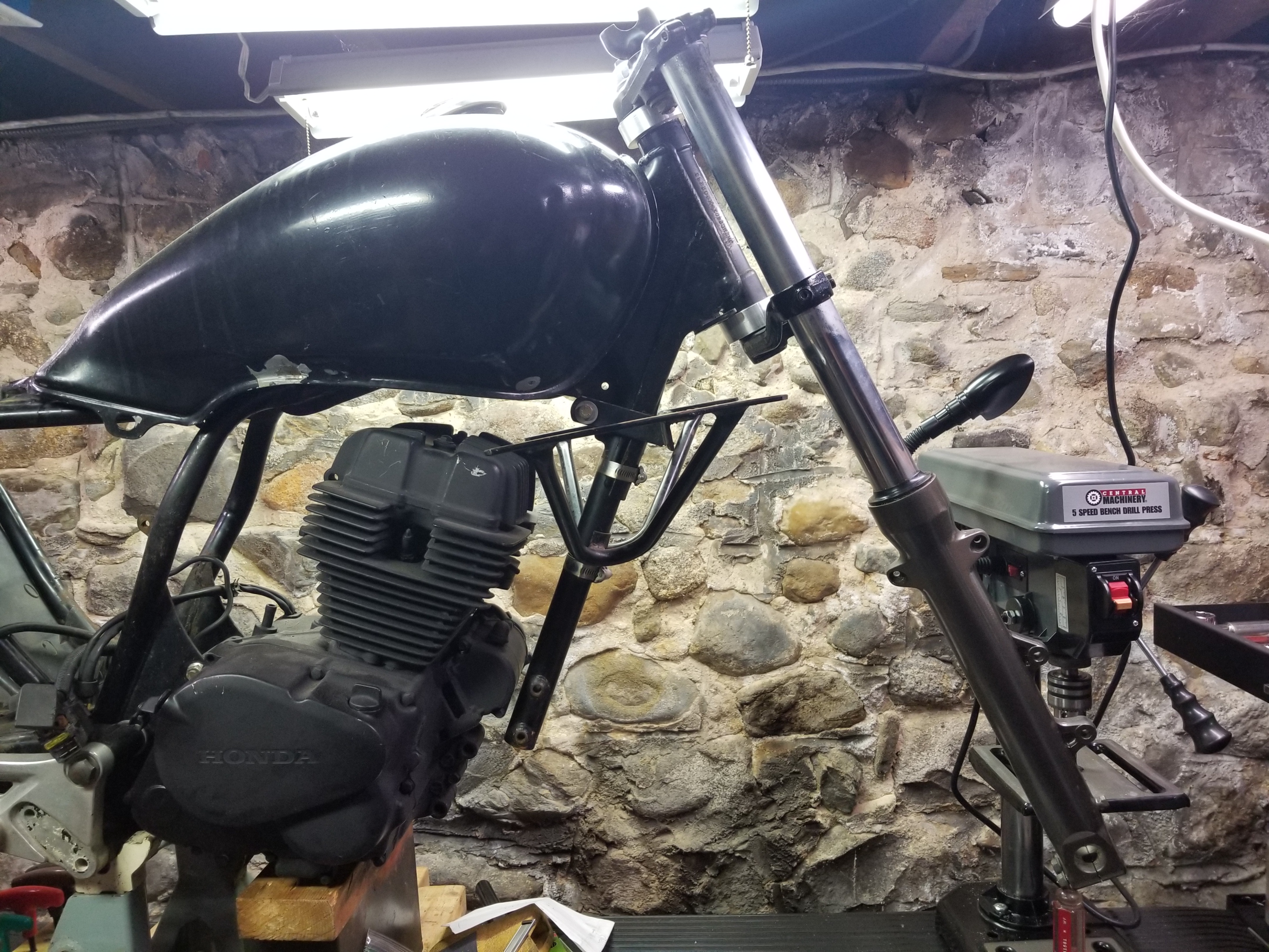

Finally an update to make on this thread! I picked up an original single downtube mount in a deal with a Vindicator and a fairly nice old backrest.
Today I brought the mount down to the workshop and test fitted it to the 250 Nighthawk I've been slowly working on.
The saddles on the mount have a 1.75" radius and the NH front downtube is 1.25" so that will have to be overcome. But in general it fits and I'm calling it a win. The tabs that bolt up aft of the frame neck have 2 spacers on each side, the pinch-weld at the bottom of the frame here is just pinched between the two sets of spacers as I didn't want to drill a bolt hole in the frame just yet.
I was a bit concerned about the steep angle of the top mounting rails, but after a look around it seems normal.
