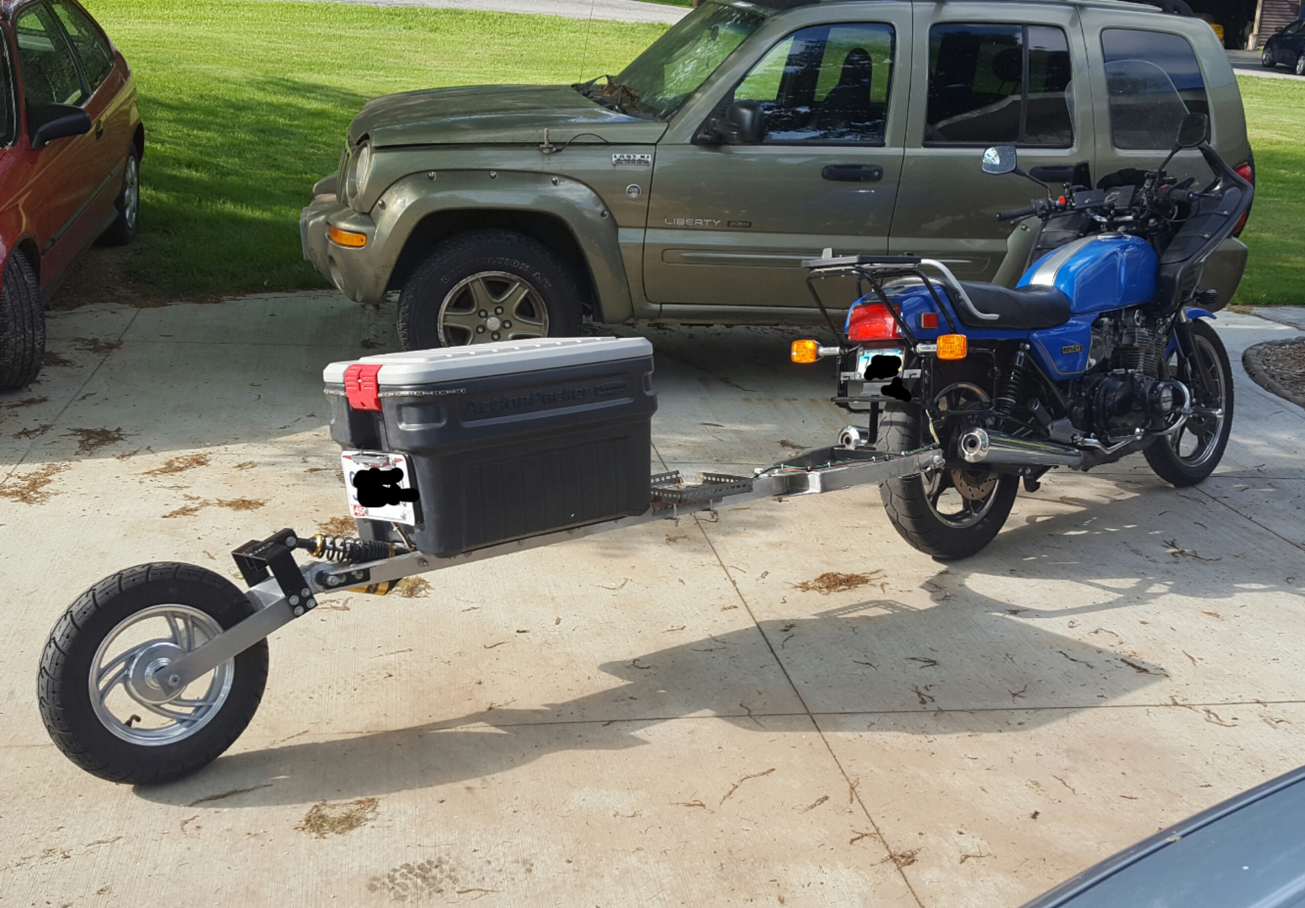

Finally finished my trailer hitch and wiring for my single wheel trailer on my suzuki gs850g. Took a guick spin around the block last night and no problems, on to the full testing before using it for long distances.

Finally finished my trailer hitch and wiring for my single wheel trailer on my suzuki gs850g. Took a guick spin around the block last night and no problems, on to the full testing before using it for long distances.View attachment 2120

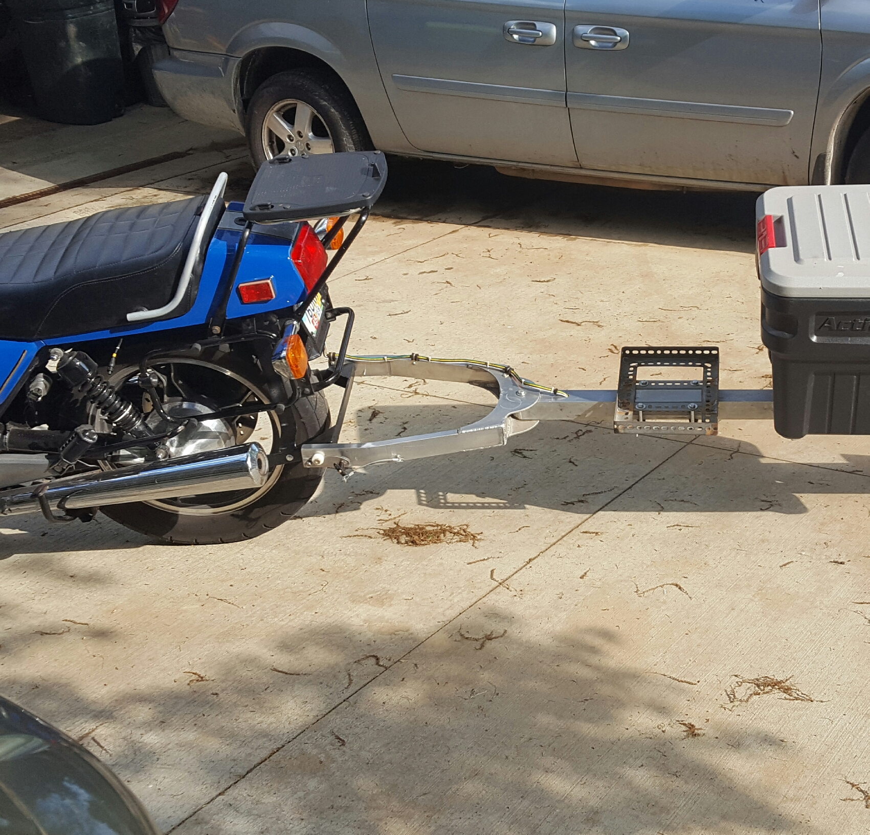

Here is a picture of the hitch (more trailer side than anything). The trailer was originally designed for my busa. On the busa it mount to spools that are in the hollow axle. With the 850 I had to move it back but instead of a complete redo I kept the "yoke" and just let the trailer sit back a little.
As for lighting I am a strong believer in the k.i.s.s. method, as such I used two simple led strips on the top corners of the box as combined turn and brake.
