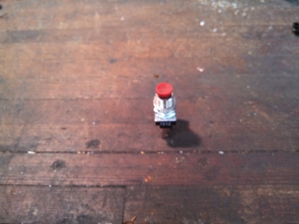

Here is what I use:
Just a simple push button switch I picked up at my local NAPA store.

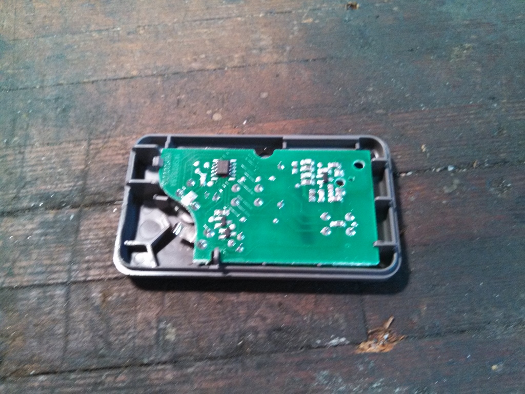

First, open up the remote and expose the mother board:

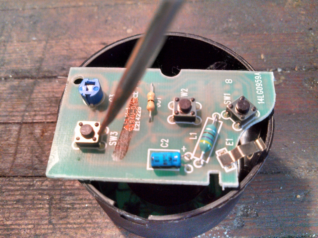

Then find the micro switch that is used to actuate the door switch:

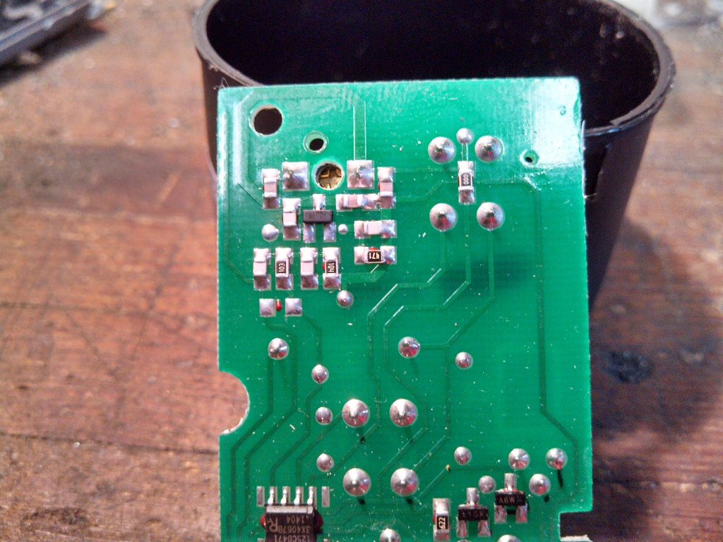

Flip it over and find where it is soldered to the mother board:
This one is soldered at four points. The trick now is to find the two points that are the incoming and outgoing lines. In this picture it is the two that are on the bottom:

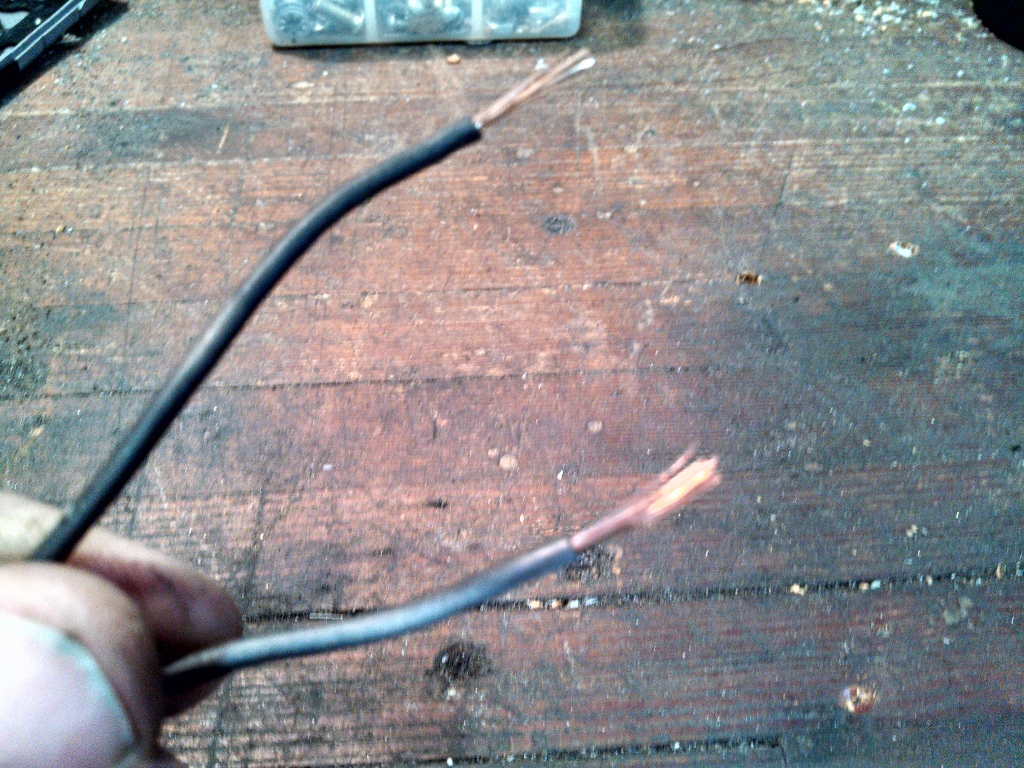

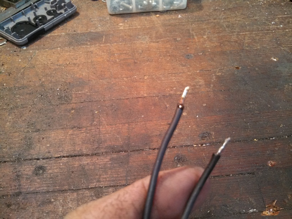

Next, take some wire and strip back the insulation:
And then pre-solder the ends:

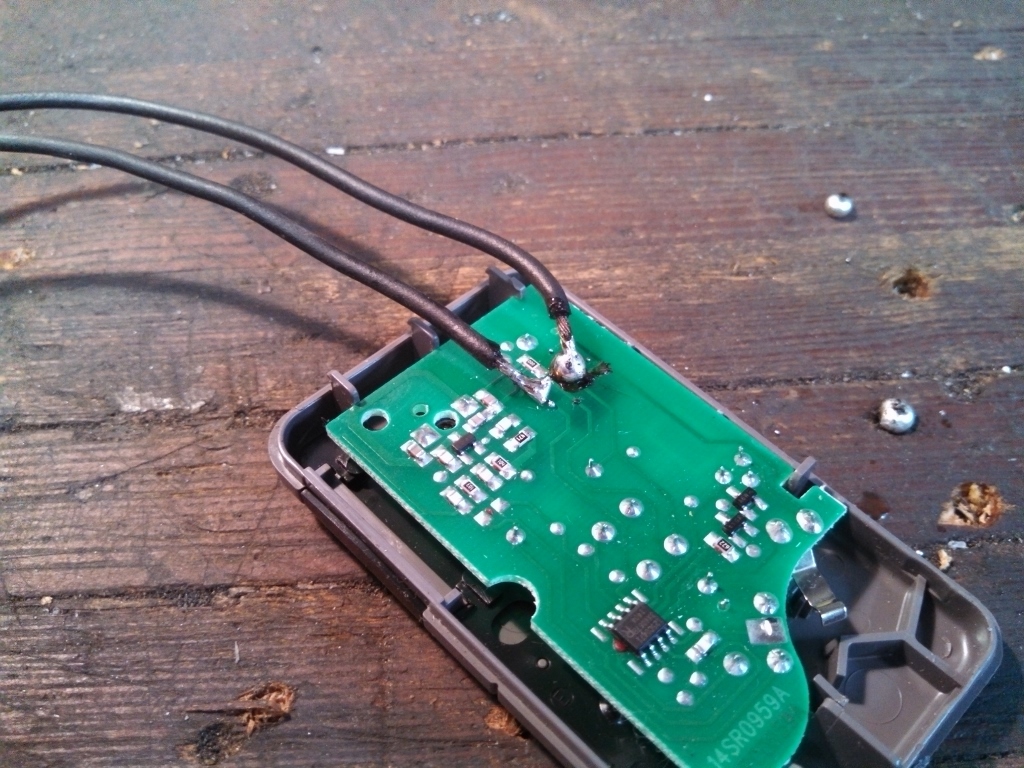

Then it is just a matter of soldering your leads to the two points on the mother board:

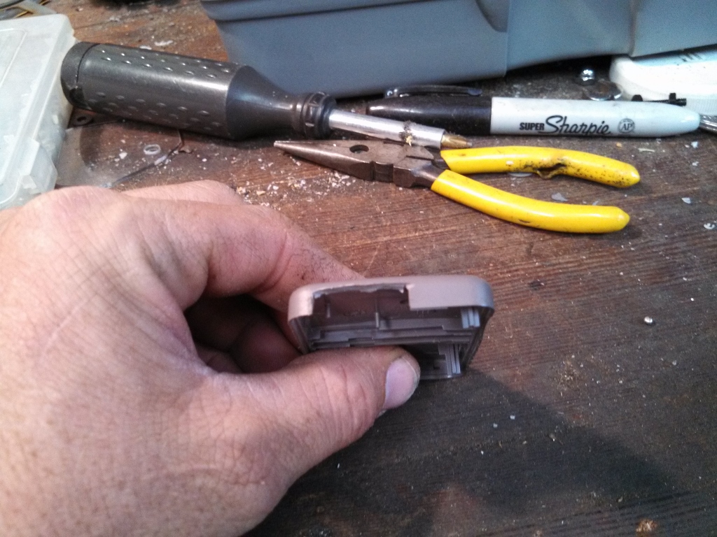

The next problem is closing the opener remote. I used a dremel tool and removed some of the plastic from the end. It doesn't look pretty, but it doesn't matter:
Close the remote back up because you are done with it.

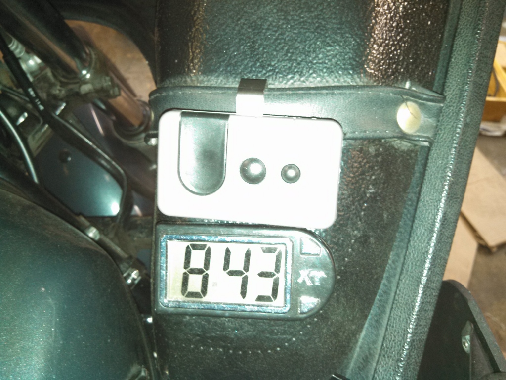

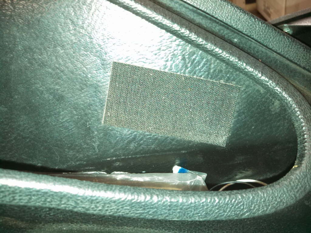

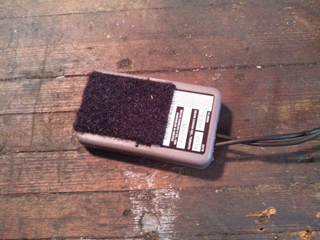

Now locate a place inside the fairing to mount it. How you ask? That wonderful thing brought to us courtesy of NASA... Velcro!
Stick it together, drill a hole for the switch and mount it.
After that, it is just a matter of pushing buttons! Start to finish, 21 minutes. A decent way to spend the night while it was thundering and lightening outside.
