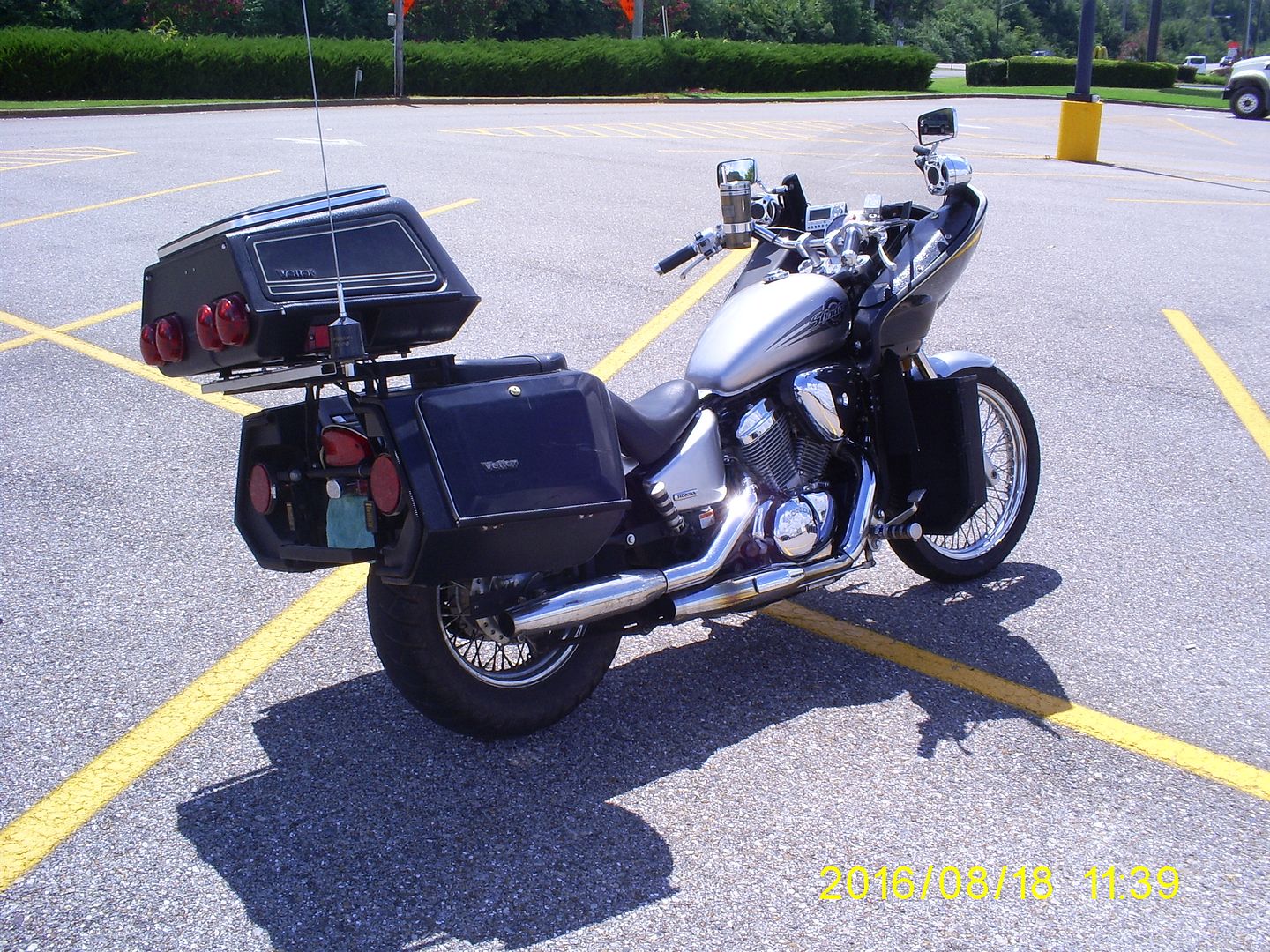

Mike, welcome, and it certainly can be done. Since all WJ's use the same mount bolt pattern, I suggest starting with finding a mounting bracket for (or from) a bike with a frame configuration that is closest to your bike. For example, I mounted a WJ5 on my '96 Nighthawk 750 using a mount for mid-80's Honda 750's. Be sure to check out the pics:

I am confident I have seen a post about your fitment of a wj to an xvs, can I ask for any measurements you have for the mounting frame height from the ground, it would help me a great deal with my fabrication and modifications to existing kit.
