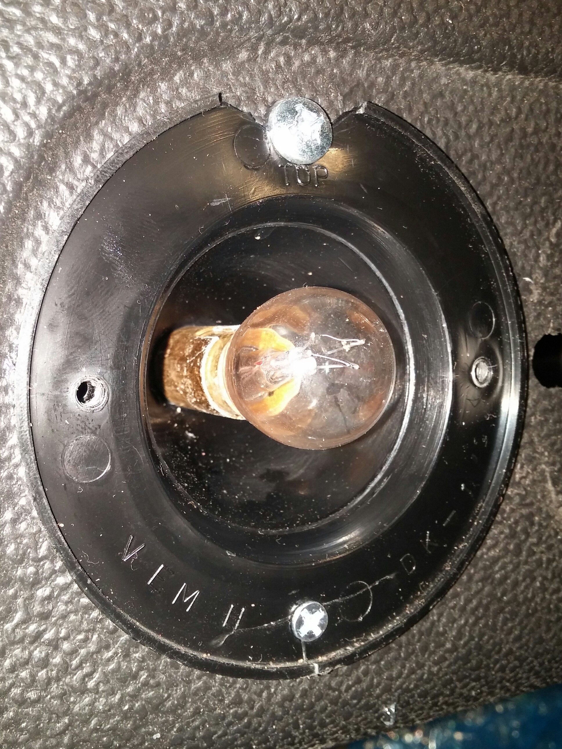

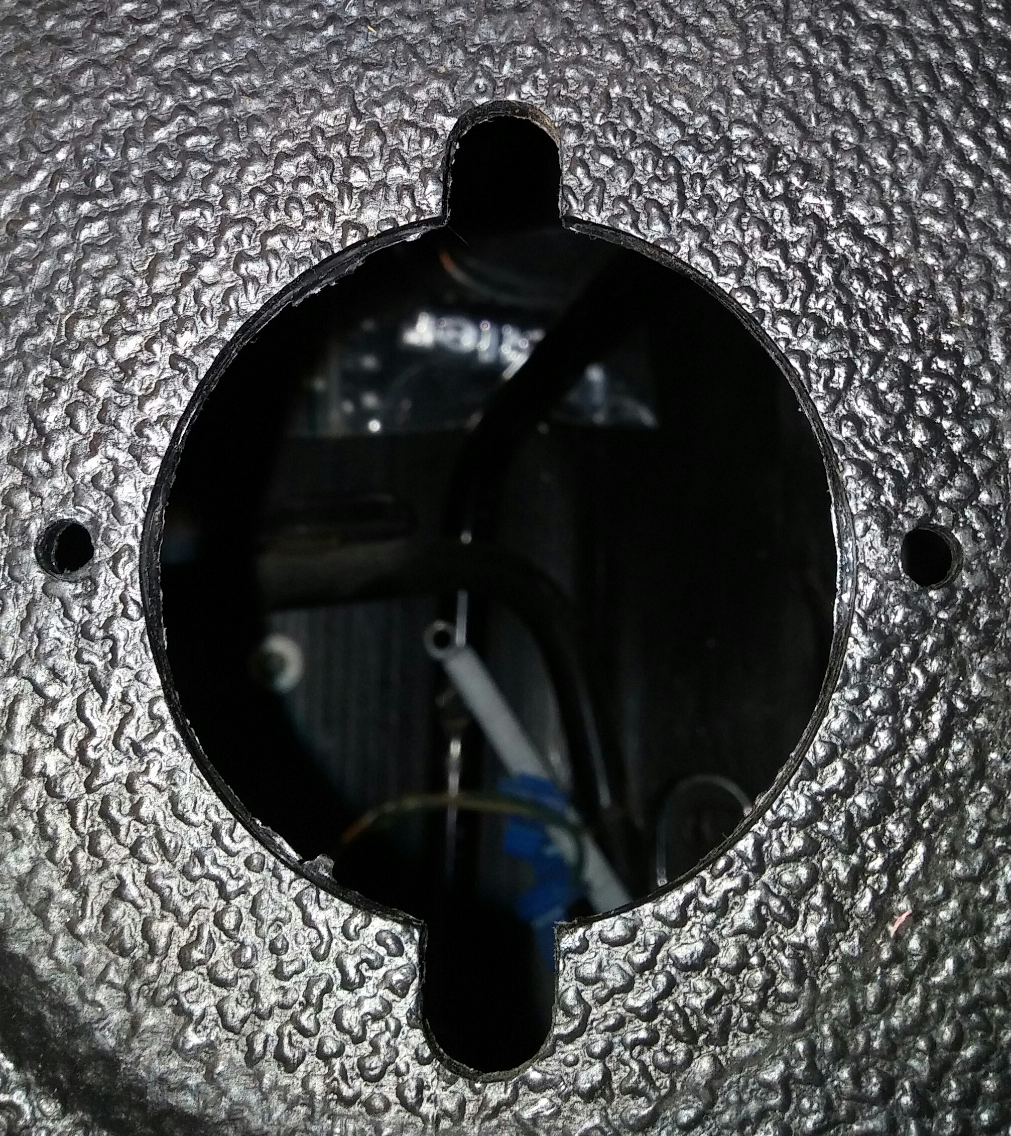

    I do now lol first pic is where I got rid of old rivets so I could add hardware once set in place.

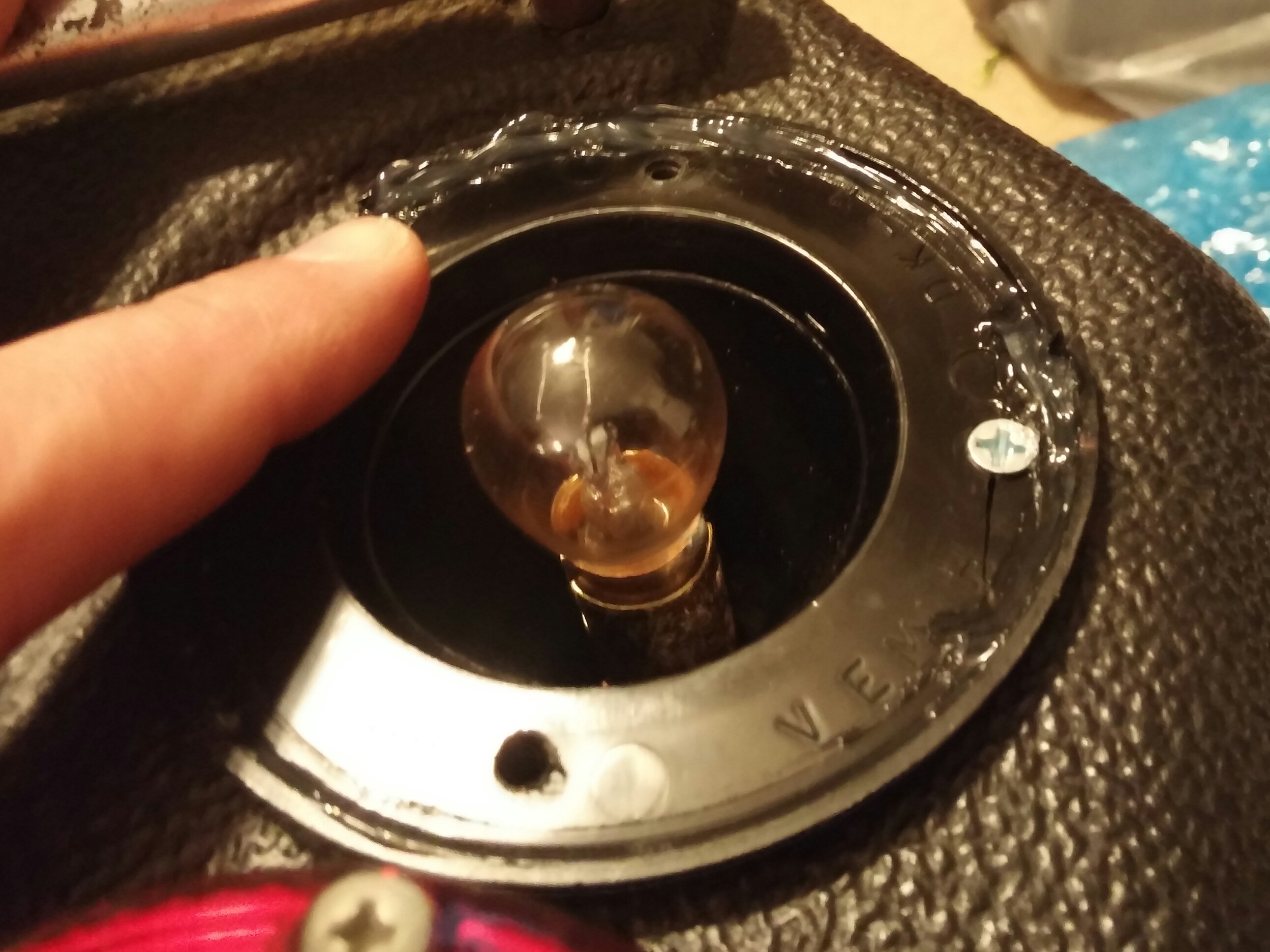

    Then i used silicone to help support and weather seal it.
    Then small screw to hold where there was still enough plastic on the back piece and larger screws to lip over where there wasn't enough.

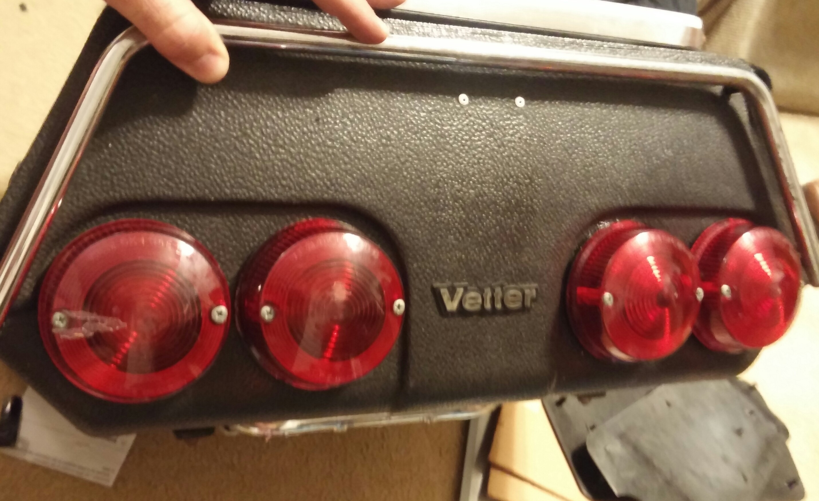

    Then added the lenses.

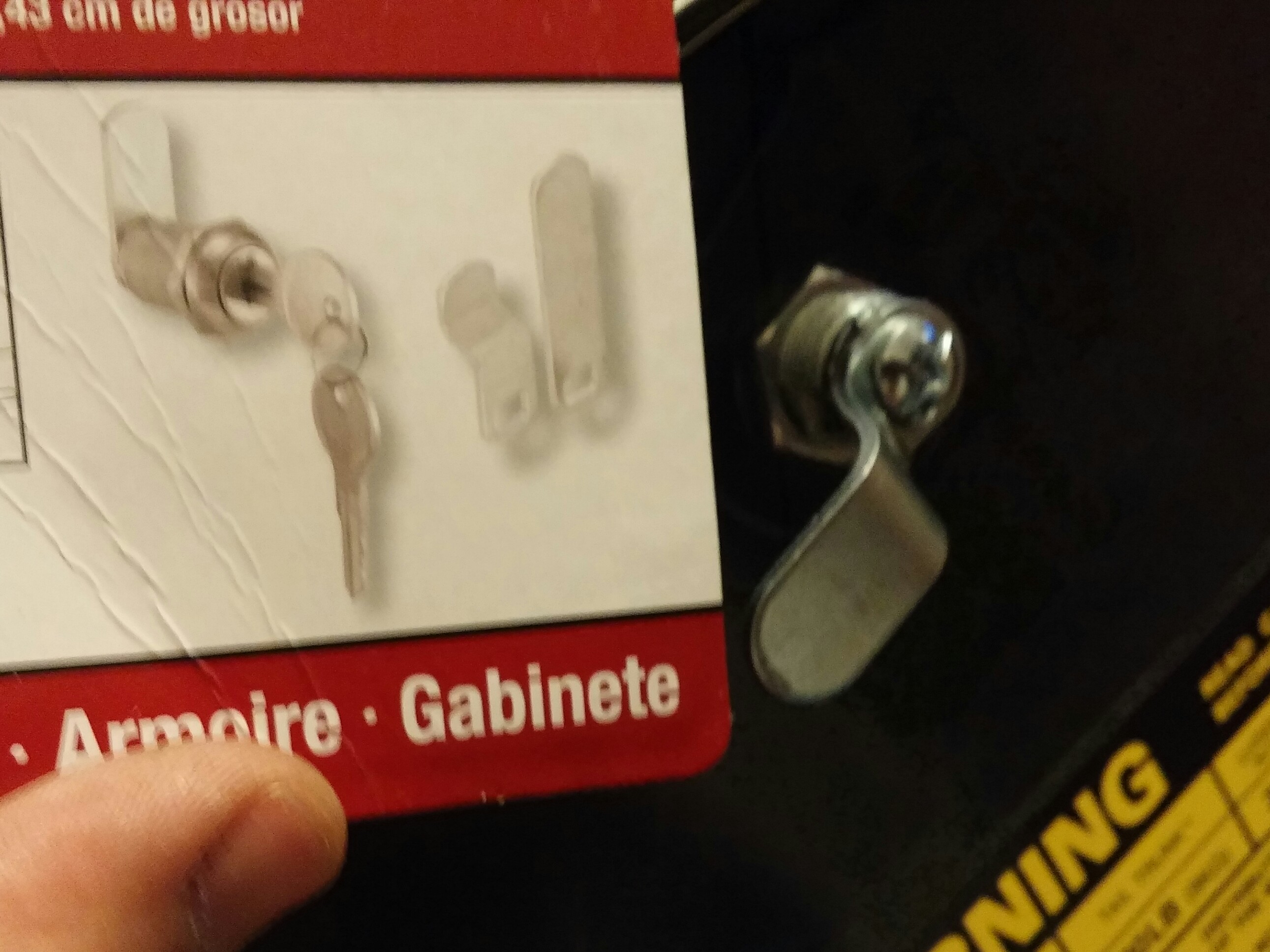

    1030152049a-1.jpg I also replaced the locks for the trunk lid and the tonneau cover, the squares on the ends of the locks weren't the same, so I had to do some bending of the metal on the new locks to make them fit. But, now I have smooth gliding, matching keys. I'll be trying to match the locks to the side boxes next.

    I realize I didn't actually fix my brackets, however, I'm the only person that will ever see it with the lenses off, so im ok with the permanent bandaid type of fix rather than going with non oem parts. So far everything I've put on this bike has been strictly 1980 parts other than the head unit and throttle lock, which my next radio will look original.

    A good thing about the design of these lights is that once the lenses are in place, those screws are enough to hold the light together.

    A local locksmith hooked me up, he found locks with the smaller squares and matched all 6 to the same key.
