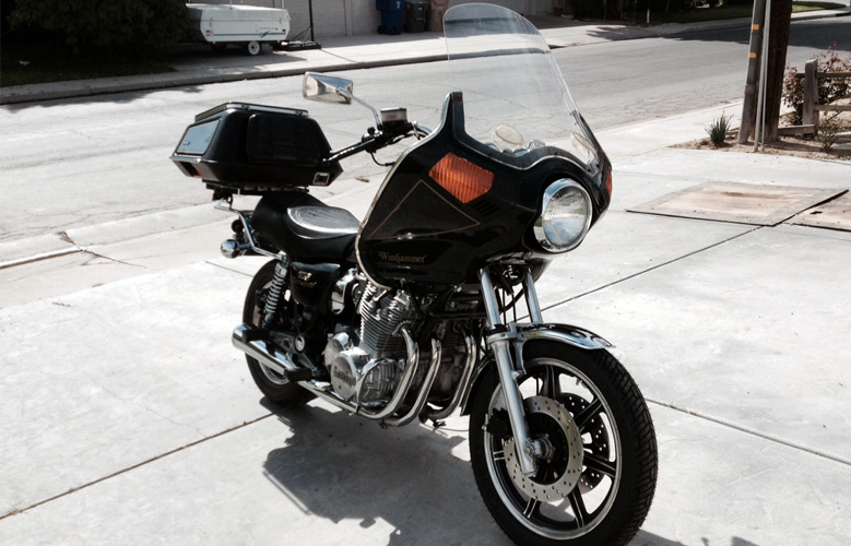

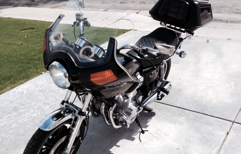

Okay, here is the update I promised a week ago.
What I did this round is as follows!
Front Forks Rebuilt by Race Tech : http://www.racetech.com
Tkat Front Fork Brace : http://www.tkat.com/forkbrace.html
Front Rotors Drilled, Balanced, and Surfaced by Chris Schumann
Rebuilt Front Calipers : Self Rebuilt
EBC Organic Front Brake Pads : http://starcycle.com
Front Galfer Stainless Steel Brake Lines : http://starcycle.com
All Balls Front Triple Tree Bearings and Races : http://starcycle.com
Front Metzler Lasertek Tire : http://etirebroker.com
Front Wheel Bearings : http://starcycle.com
I am currently redoing the rear end. Also, the front end felt really really good.

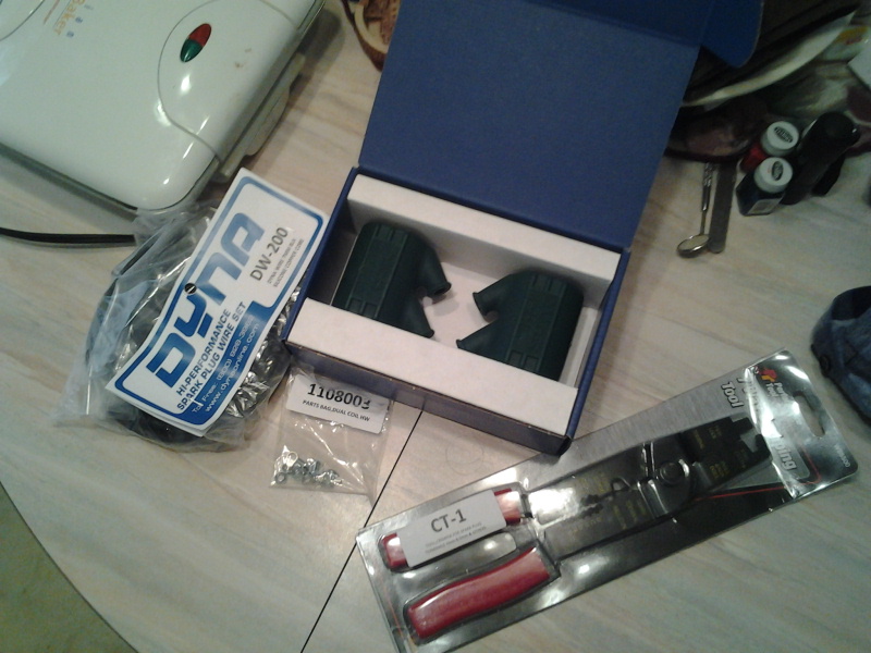

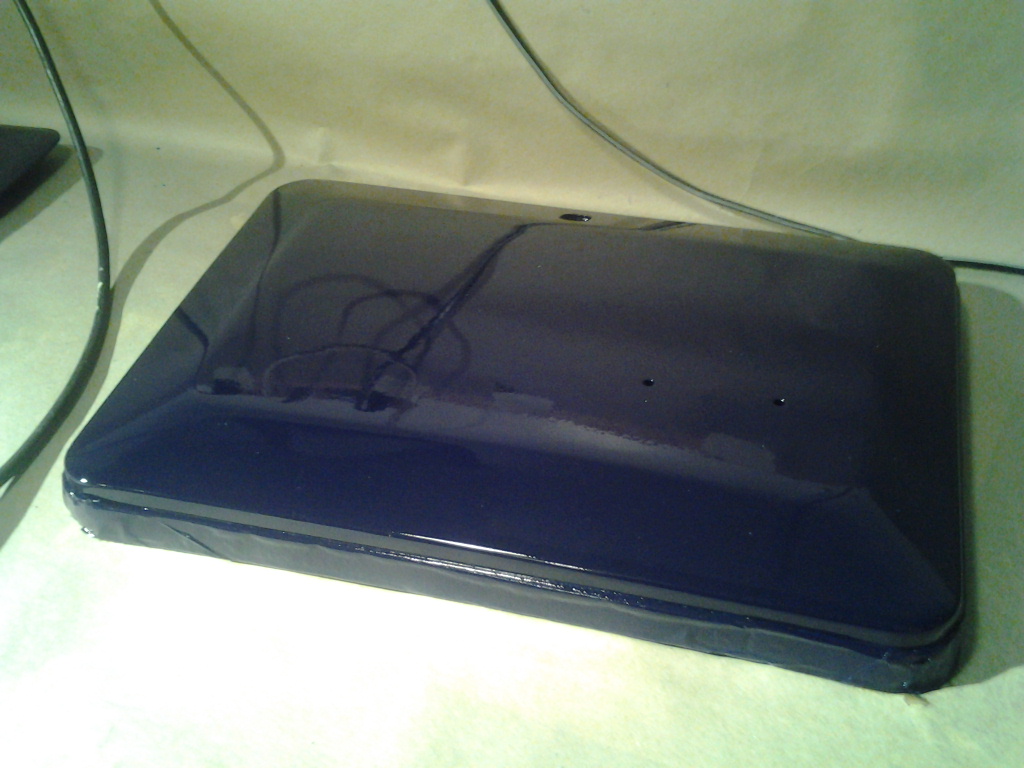

For me I was able to get my Dyna coil pack, wires, and the crimping tool. All the doors are apart on the luggage. Fairing was striped down wet 1000 taped off papered. Trunk, bags, ie, doors ready for assemble. Phone camera. The dust has settled on dried clear coat. After the all dried in the back of my Toyota Truck. Midnight Blue from Dupli-Color. Went down nice. @ the surface it is a Kris Cross pattern. Kobalt gun. I'm 10 years rusty.. :( Oh am most definitely not done in a weekend...

I have a love hate relationship with painting. With growing up around a father who was a vehicle painter, I spent most of my youth color sanding, stripping, blocking, taping, and waxing. Years later, I think I am still scared to take up painting again.

I was looking at the images of my XS and I really like the look with the drilled rotors. I was skeptical of drilling them, even know some of the later models are slotted, and they look good. All in all I am extremely happy with the look of the front end!
