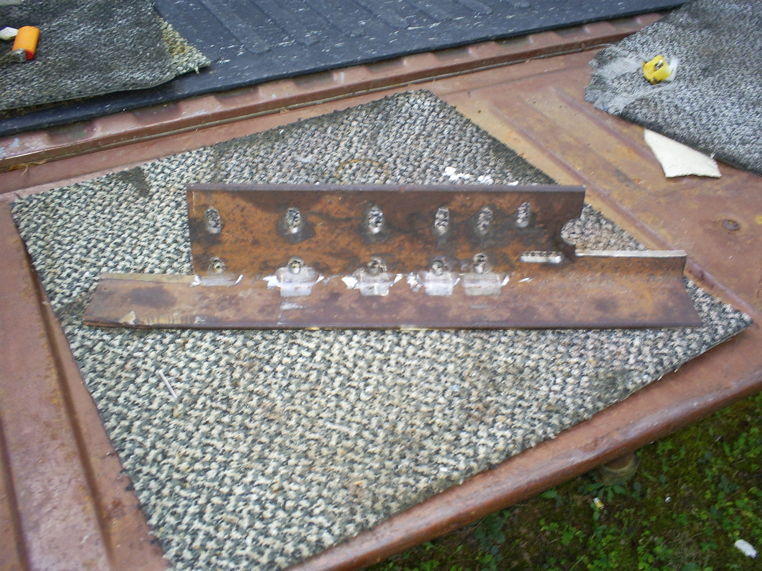

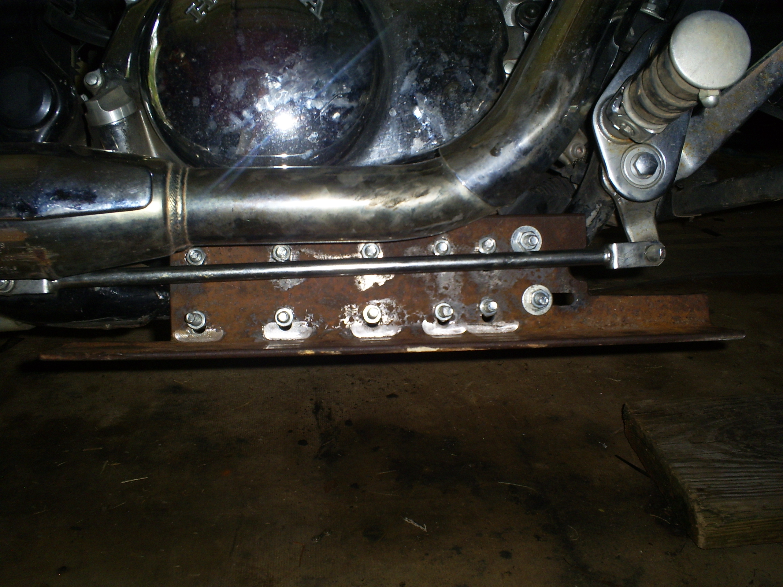

I fabricated an adapter for connecting the Bike frame to the sidecar frame. It's made of 2" X 4" X 1/4" heavy angle iron. I am using 6, 3/8" X 1.25" U-clamps to attach the adapter to the motorcycles frame. Two of the clamps are attached to the frame tubing where it starts curving upward so I never need worry about it twisting on the frame tubing under load. I had to slot the clamp holes where the U-clamps pass through so it would go on and come off easy. I attempted to get it on with just round drilled holes, which proved impossible to do. The U-clamps have very little clearance between the engine and frame tubing. The slotted holes allow a little leeway as you put the frame adapter and U-clamps on and off. I still need to make and attach two clevis's that will connect to the sidecar frame . I'll do that after fabricating the sidecar frame.
