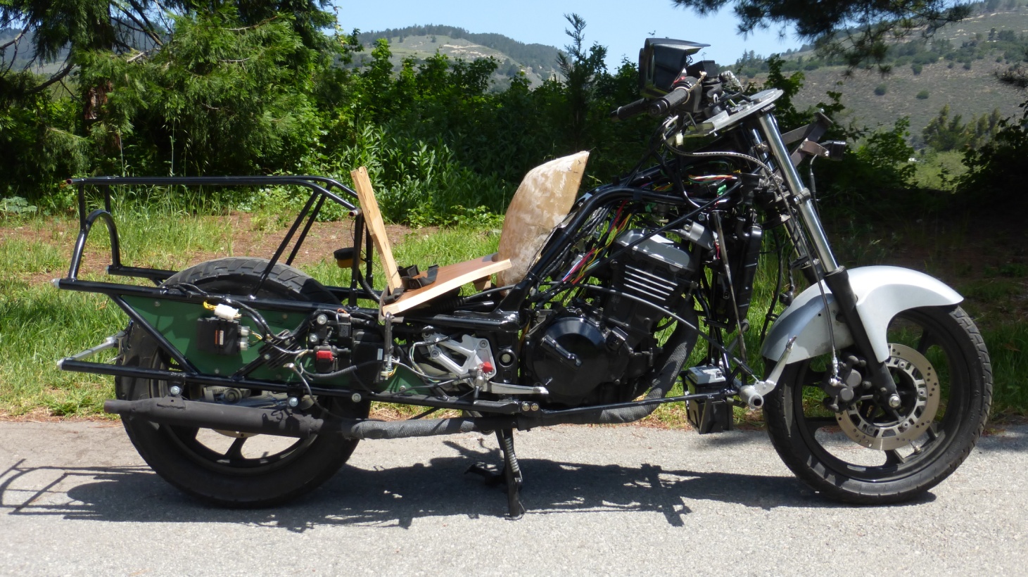

  19. Alan Smith
    Alan Smith Grasshopper
    Mar 7, 2014
    11
    Hello Everyone! Sorry for my long silence. I've been very busy working on the next generation Vetter streamlined Ninja 250. This project is going much slower than expected. Once you start cutting the motorcycle frame (extending it to lower the rider 11-inches) nothing will ever fit again. I sit where the engine's stock air box used to be, 11-inches lower.
    I had to build a new air box, custom extended swing arm, special exhaust to clear the center stand and side stand, mufflers, etc. Special cables and hydraulic lines also needed to be made. The modified wiring harness was no fun to build.
    In the photo below you can see that the battery is now located below the radiator. The bottom of the radiator had to be moved 2-inches forward to clear some brackets.
    The new all fiberglass turret and nose has been built. The mold for the new fiberglass back rest is almost compete. So the tail has a long way to go before it is finished.
    The fuel tank still needs to be designed and built. Right now it looks like the fuel tank will mount along side the lower triple clamp and radiator area. Even the size of the fuel tanks are now known yet. I prefer two 1.5 gallon fuel tanks. Craig Vetter thinks larger fuel tanks should be built. Regardless I still want a fuel range more than 300-miles, that would be the duel 1.5 gallon gas tanks.
    Sadly I don't think this bike will be finished in time for this summer's riding season. The summer riding season is fast approaching and I plan to do a lot of riding again. At least I still have my current Vetter streamlined Ninja 250 to ride.
    Photo shows the next generation streamlined Ninja 250 with all the aerodynamic bodywork removed.
