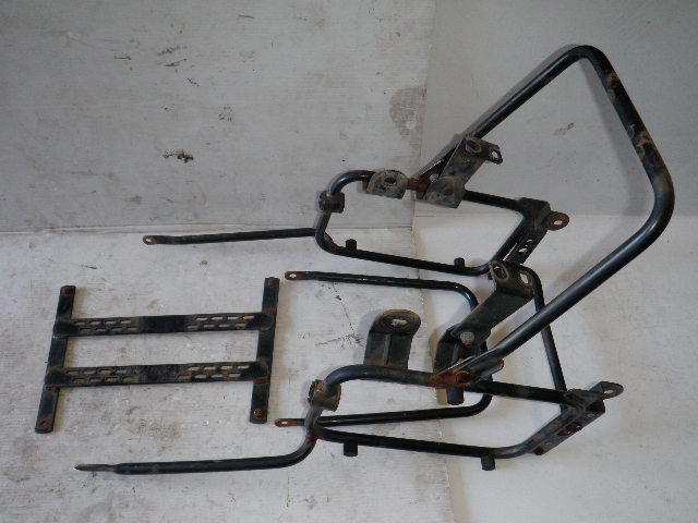

trying to mount VETTER trunk to a 79 KZ1300...NEED HARDWARE HELP Ya'll

I BELIEVE ITS THE HARDEST PART IN THE WORLD TO FIND NEXT TO A BRAKE MASTER CYLINDER ON THIS PARTICULAR MODEL...BIKE HAS BAGS ALREADY BUT WANT TO ADD THE TRUNK.

See framework attached to trunk in pic ..
This I SEEK ..

The luggage rack in the picture is made by K&G enterprises. They show up on evil-bay quite often. The problem is the cost for the condition that they are usually in. The good thing is, they are pretty much universal.

I'll Chk center to center measurements as well as width and post them by Monday....

The tubes are adjustable and there is a set screw that locks them in place. That is the little dimple that you see sticking out the bottom about 3 inches forward of the bend. To adjust the width, you need to loosen two bolts and spread the side tubes apart and then tighten the two bolts again.
The one I have on my GL1200 is spread almost as wide as it gets, and stretched almost as long as it gets and I can still safely lift on it to get the bike on the center stand.

I believe the above is for later year ...
79 needs this.
See attached.
2 radius bars hold trunk that connect to luggage hardware....
