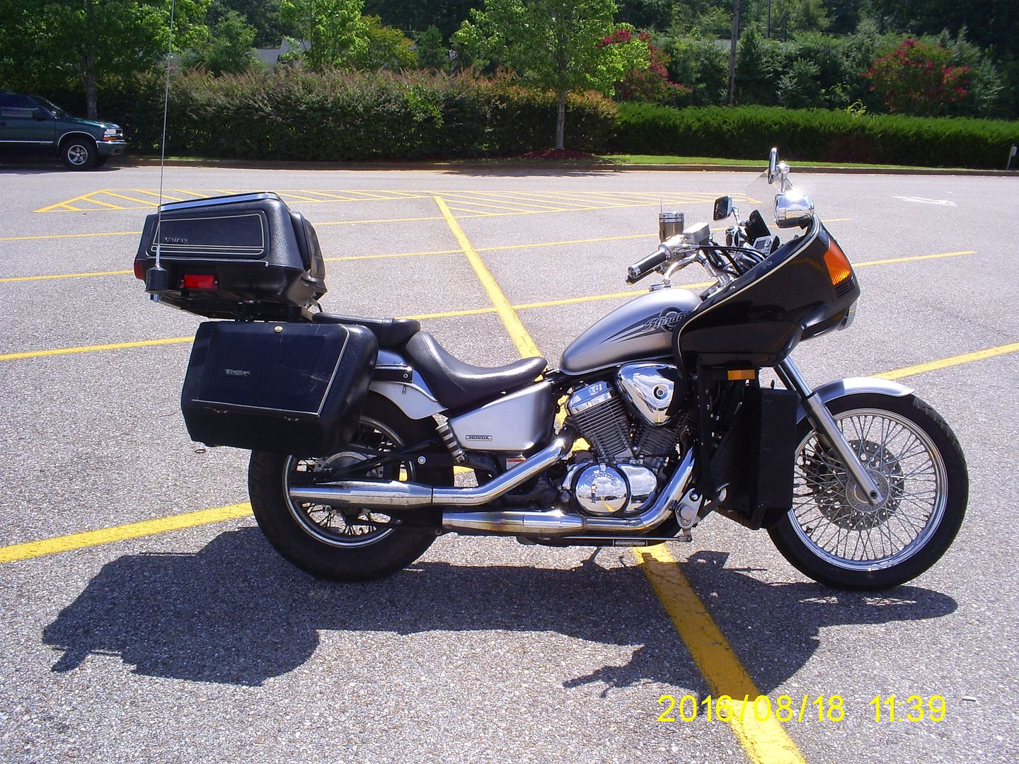

Below is a picture of my modern Honda Shadow Cruiser with a Windjammer.

Personally I think your bike will look great with that Windjammer on it . . .
Agreed. Several of us, including myself, have mounted WJ's on later model bikes. We can help, starting with the rule of thumb that the plane of the windshield should be parallel with the plane of the forks.

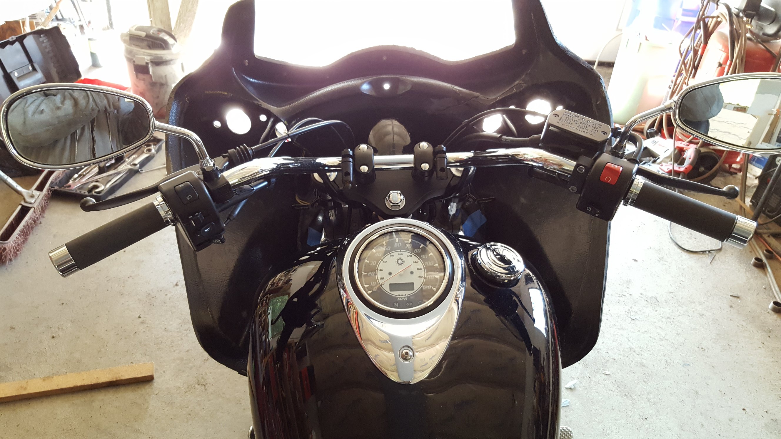

Hi Scott,
Yeah I'd already determined that the windshield had to be cut down about four inches, but that really didn't factor into my decision all that much. I think what bothered me the most was my inability to bring the fairing back far enough. A lot of the bikes of that era had a bar mounted instrument cluster and I assume Craig had to take this into account when he was designing the fairing. Today a lot of cruisers have a rather simple tank mount instrument group and this left me with a big gap forward of the bars.
As you can see here I've already cut away the interior walls of the fairing to make room for the tank. Even with that the design of the fairing won't allow me to bring it back any further than I already have. In the end what I'd like to have is the headlight situated just slightly above the stock version, but in almost the same vertical plane. And the fairing itself should sort of wrap around the tank giving me easier access to the storage compartments on either side. Right now they look like they're in another postal zone.
