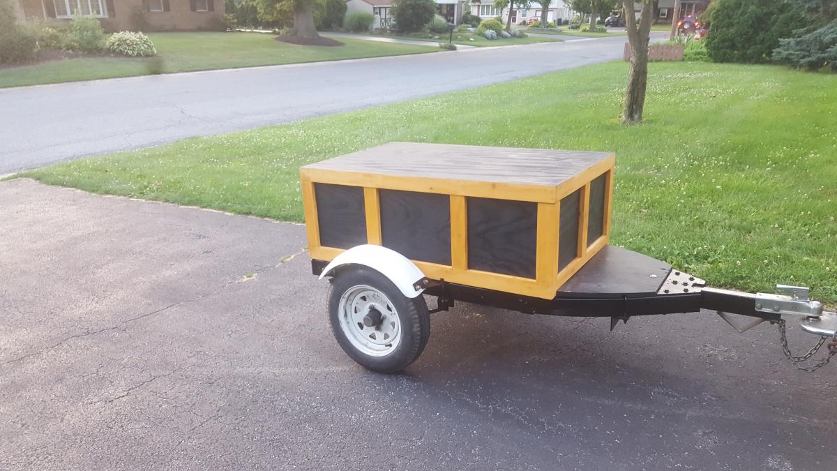

I am kind of partial to the two wheel design. This started life as a 14 foot boat trailer... it's been put on a diet.
It's nothing special, just big enough for my camping gear.
