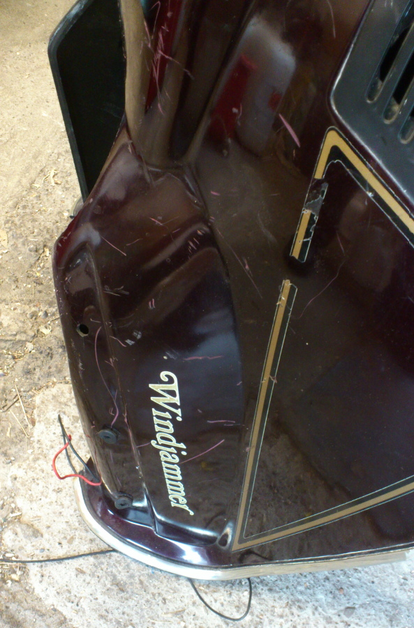

    It's not in great condition, but might clean up. If it does clean up ok, I'm thinking of just colour-matching the bike to it, in a broad fashion. Not exact, but roughly the same or complementary, so it wouldn't look wildly out of place.
    The bike was paint-potted yacht white 25 years ago, as a self-preservation measure in town and motorway traffic, which worked well enough, but it's time for a change anyway.
    [​IMG]

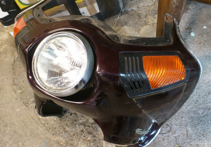

    I see I've been blighted with the ownership of a Hella sealed beam. I wonder if this fairing came off an import, which would explain the very unusual occurence of a sealed beam on the UK market, where they've been almost unknown for 30 years and more. No matter, soon replace that with something decent.

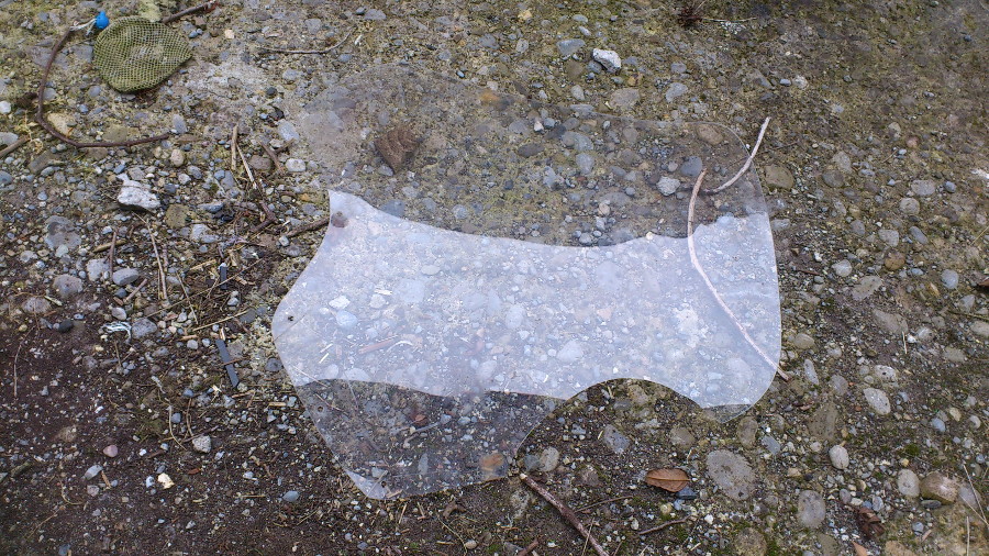

    The seller may have tried to remove the windshield without taking the clips off first, snapping it.
    However, I knew about that and asked him to include the broken pieces, so I can use it for a template for a piece of Lexan, got locally. I'm kind of surprised how flimsy the broken screen is, compared to the originals I recall.

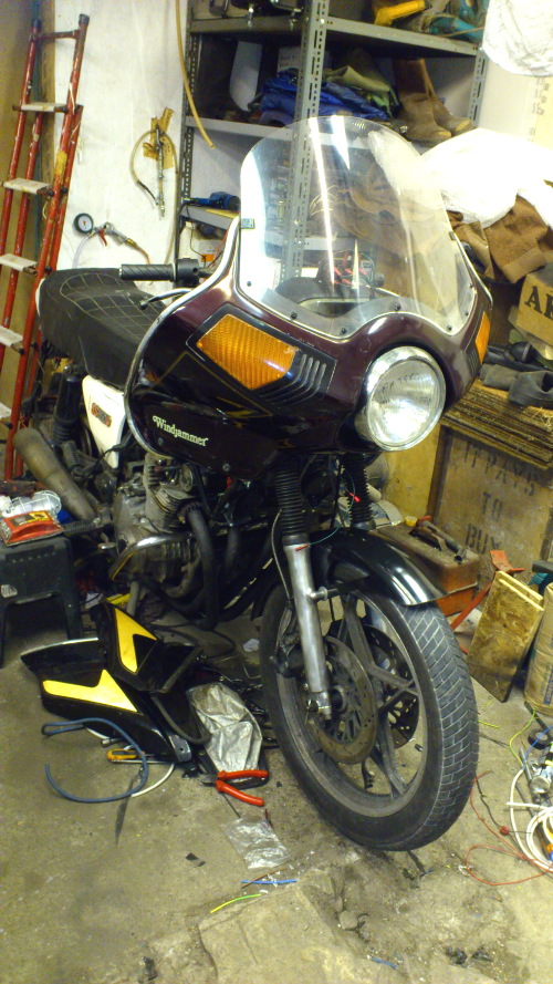

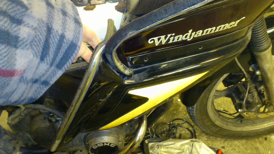

    Bracket mounted and fairing test-fitted temporarily.

    I also discovered something interesting - the GS850 bracket is nearly a perfect fit for the XJ900F - if the oil cooler is moved, which would be a pain in the arm. I have a plan for that bike, though; fairing related.

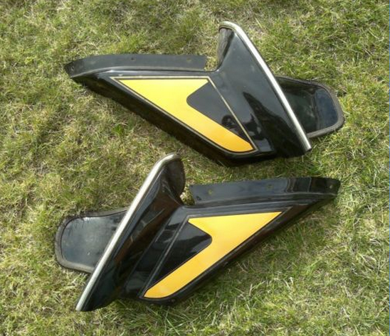

    Took a punt on a pair of lowers which looked to me awfully like they'd fit. Turns out they do. :)
    The seller had bought them in error for a WJ V - I thought they looked like they'd fit just about anything else, copies included, as I have a suspicion that many of the copies used Vetter lowers or simply copied them very closely anyway. These ones were in the same colour scheme as the Pantera II fairing, but not cut quite as much for a GWing, so suit the GS850 a bit more. Easily extended to suit, anyway.

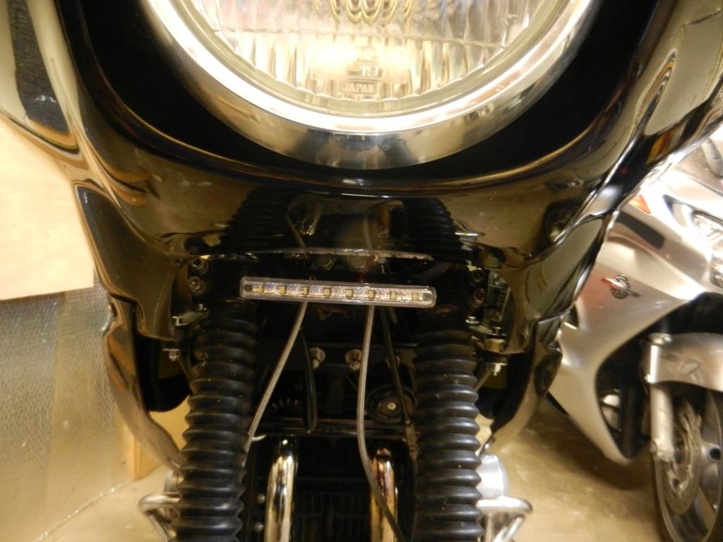

    Thats useful then then, I did try to use the Vetter amber sidelights but was told it had to be a forward facing white light. Anyway I was not keen on the Amber light idea as someone may have mistaken it for a faulty left hand turn signal if viewed from a junction so I disconnected the low wattage bulb filament and just left the indicator filament wired. It is possible to not have a side light here but the headlights must come on with the ignition without a switch thats how newer bikes get away without one.
    Picture below is the LED solution I came up with which is mounted off the front brake spliter mounting bolts.

    Dragged the WJ on top of the chest freezer and gave it a good going-over with T-Cut and Turtle wax, doing the black insides with Johnsone's Pledge. Hmm.... smells good down there, now.
    There are still quite a few scrapes and scratches on it, but it's not as bad as it first looked. I had to get technical on the donkey of the missing locked compartment key, but that's easily replaced with a cabinet lock.

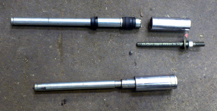

    I had a lovely time trying to remove the internal bar weight mounts from the ST1100 handlebars. The first one came out with a lot of lube and persuasion from a slide hammer, but the LH one just wasn't shifting. I'd doused it with penetrant from inside and out and in total it had been left for a couple of days. Today, it grudgingly started to move, but the slide hammer wasn't filling me with hope that the handlebar mounts would withstand a lot of that. I resorted to making up a jury-rigged puller, which worked well in getting it out for an inch or so, and after that, the slide hammer jerked it out cleanly.
    [​IMG]
    Simply a long socket of 16 or 17mm, a 4" bit of 8mm all-thread and a nut+washer. I should have done that in the first place, would have saved a lot of grief.

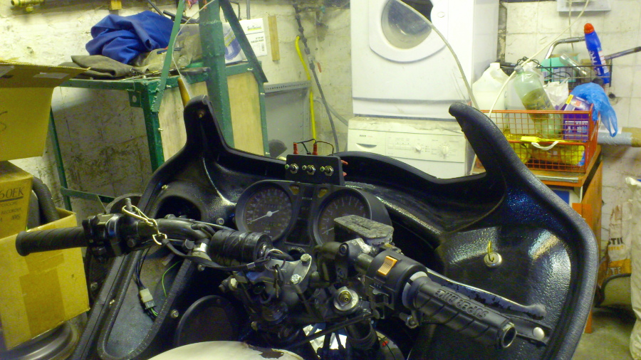

    Finally got the WJ IV fitted, only to discover an annoying slight unsymmetry in the bracket and / or fairing. It's only obvious in the spacing twixt fairing and fuel tank, but it might be the bike the bracket came from was laid down and the bracket pushed over to the left a bit. It will do for now though, and I simply am not going to take it off and mess around with it any more. When the valve clearances next need done, I'll do it then.
    Anyway, the fairing sits well enough on the bike for now, complete with the shorty screen from the other WJ IV (the blue one).
    [​IMG]
    The lowers are from an unknown source, but they're identical to the Pantera ones that came with that fairing. They needed a bit of trimming, but will fit ok, once I drill a couple of new holes and get new well nuts from ebay.
    [​IMG]
    [​IMG]
    I want to fit a trio of instruments - Volts, Oil Temp and Clock as minimum. If I fit a bar-mounted clock on centre and simply fit Volts to the left and Oil Temp to the right up top in small individual 2" pods, it will leave space for a modern deckless stereo. I don't need a Cycle Sound on this one, as the 4" speaker holes are already cut in the sides, so may as well make use of them. I could fit the radio head in the left hand cubby hole, but I'd like to keep the storage as open as possible.

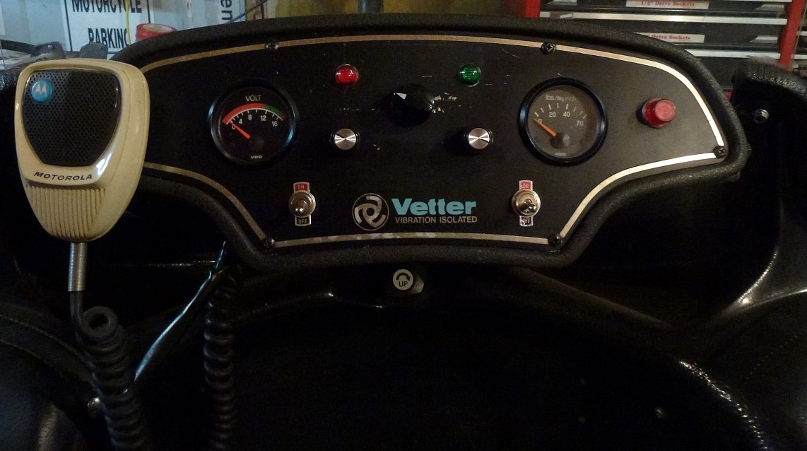

  19. AVetterXS
    2,021
    454
    How about a Vetter Jetcockpit?
    vetter-jetcockpit-vdo-instrument-panel.jpg vetter-jetcockpit-vdo-instrument-panel-inside.JPG
