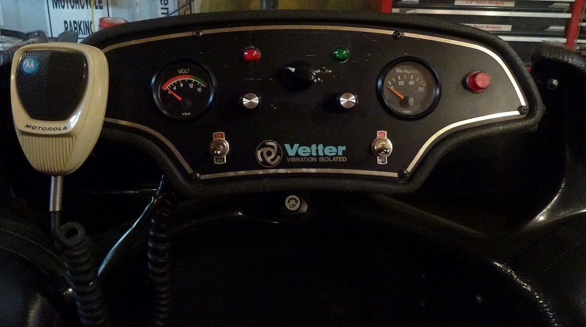

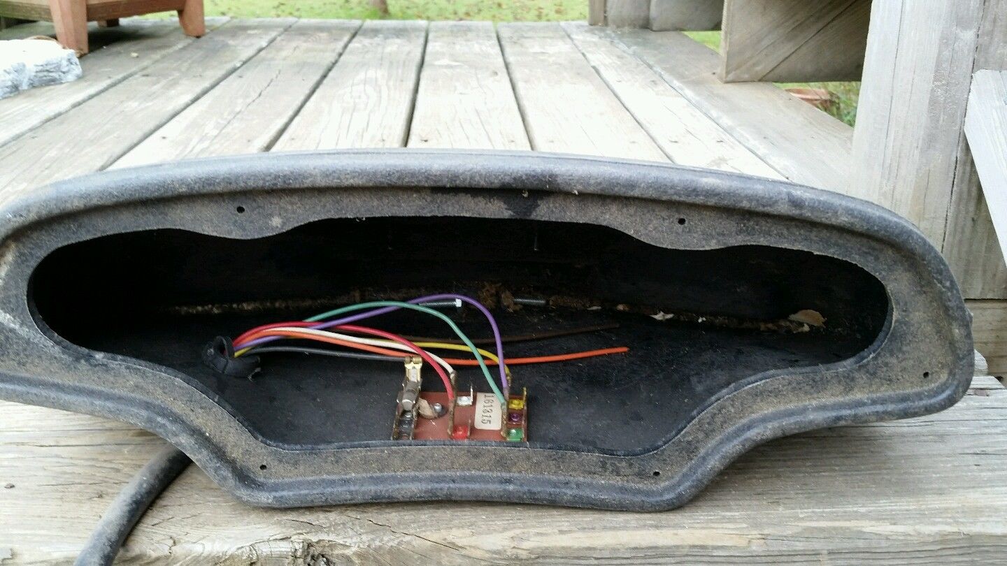

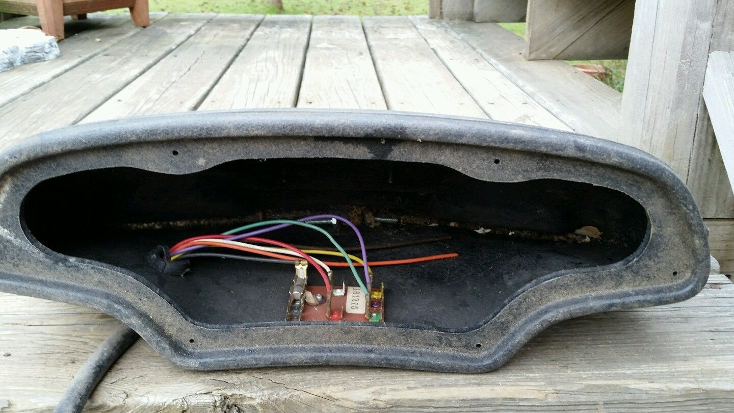

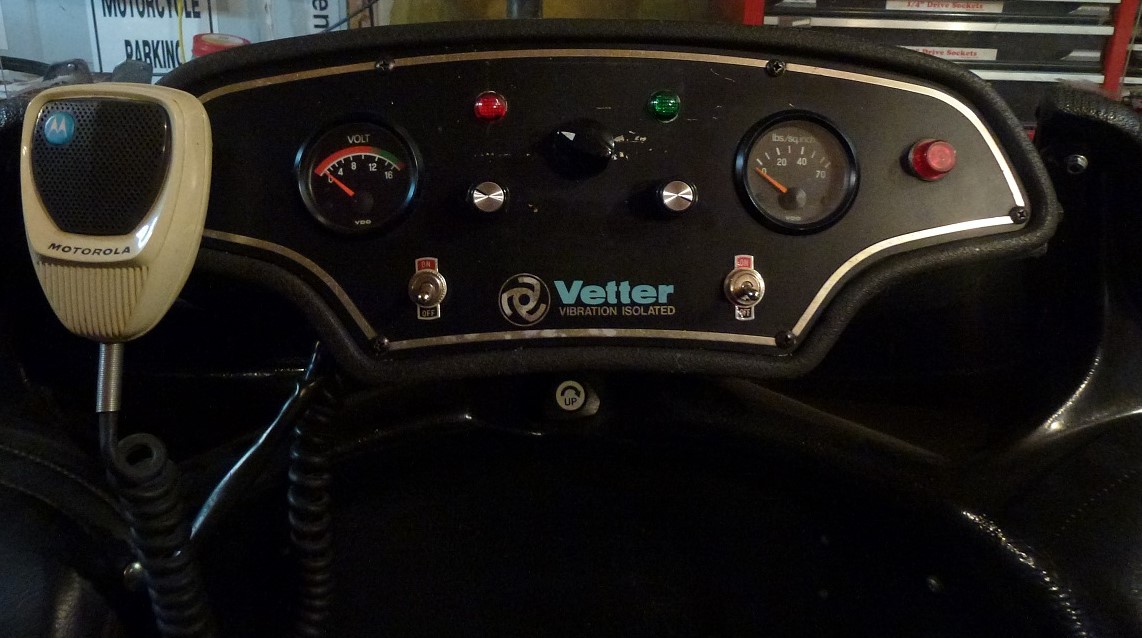

I have one, but the condition is poor and its really been cut up. I am looking for one in good condition with the gauges. I will see if I can locate the one I have and see what condition its in.
I found the seller of that empty shell, and he'd failed to sell either of the ones he had so he'd dropped his price a lot. I expressed interest, but he hasn't come back to me. The empty one suits me, as I can make my own front plate, to suit myself.
2,041
456
44
#28
Thats a good idea. Ill still check for you. Ill let you know today.
