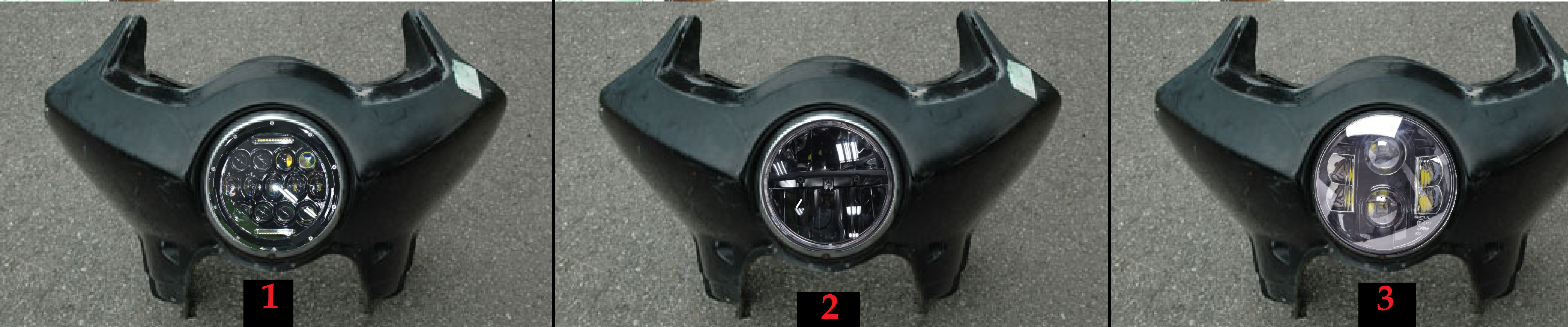

which one of these headlights do you guys like best?
I'm planning on getting one of these, I just can't decide which one.

Ooooo! I have to go do some research now. I also like #1 because it appears that it will provide the widest coverage area.

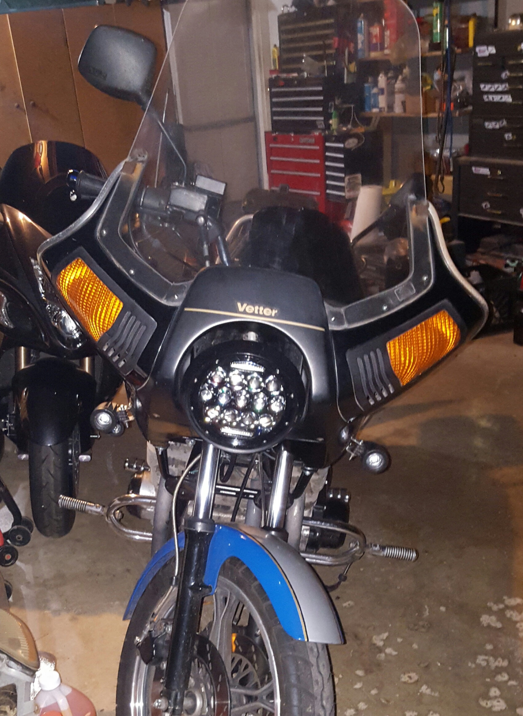

As far as light output, I'm not jumping for joy. The low beam is fine for most riding. The high beam is ultra bright and if i can get it aimed correctly I think it will do very well. Currently the high beam is aimed to far down and does more harm then good as the glare from the road limits my view.
