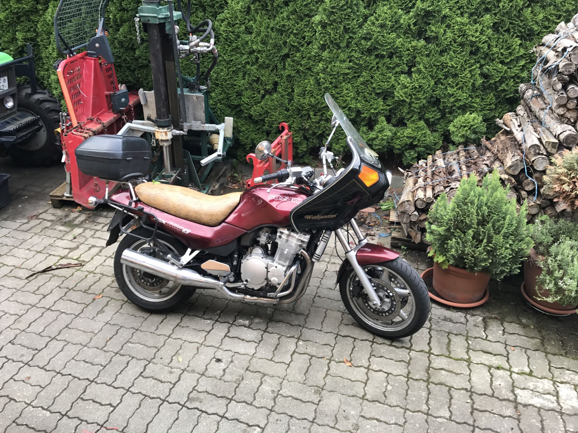

    Hi Folks,
    as already postet in my introduction, I'm planning a WJ 4 on my '93 GSX1100G.
    As I live in Germany and we have regulations for nearly everything - the first step was to clarify with the local TÜV (those are the guys doing our vehicle tests) whether they want to allow this fairing on my bike.
    I had to bring certificates from other bikes with this fairing - luckily I got one from the Kawasaki Z1300. As this bike is slightly "fatter" than my ride I got the OK.
    Next step was to get a WJ - and found a BMW with lowers in mint condition. I'll pick up tomorrow. What else: a Cycle sound was missing - by chance there was a WJ with brackets for a Z1300 in bad condition however equipped with cycle sound in ebay.
    I got it, too - snd those Z1300 brackets will probably be helpful to make my own brackets. Similar to the Z1300 the GSX1100G has a large radiator mounted to the frame in front of the engine.
    Next steps and pictures will follow.
    Dieter

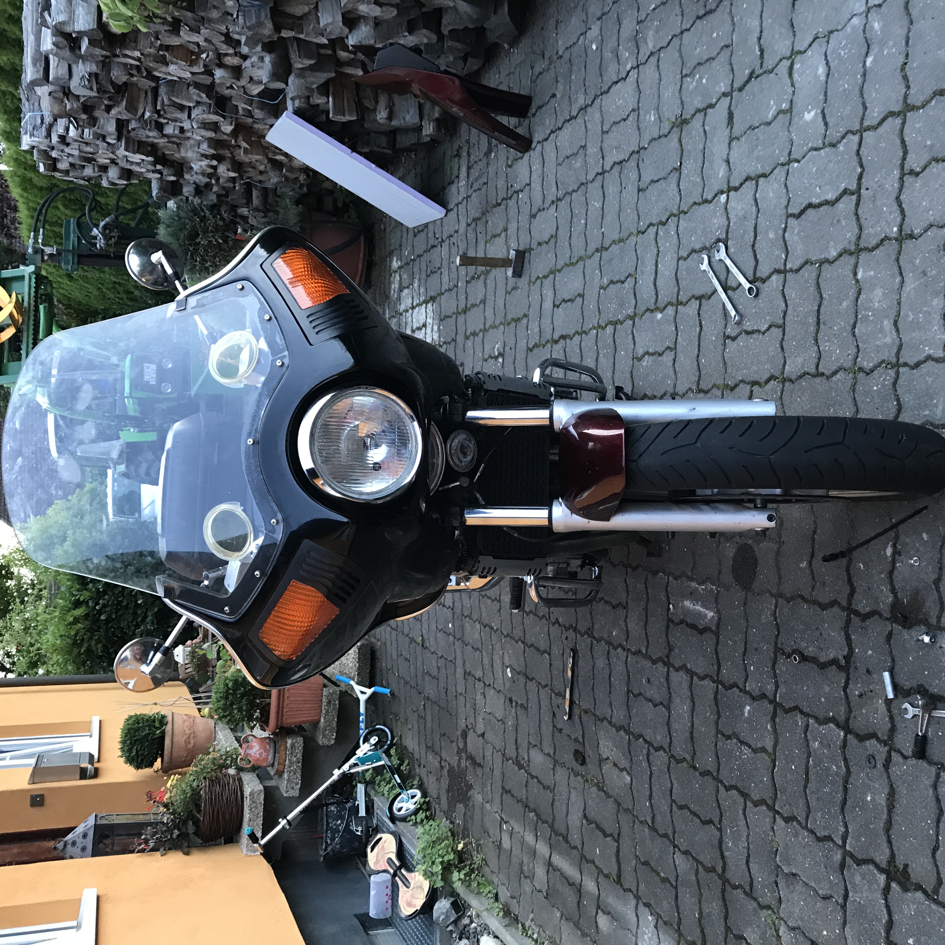

    First tests...
    Seems to be possible.

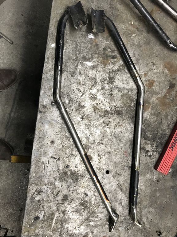

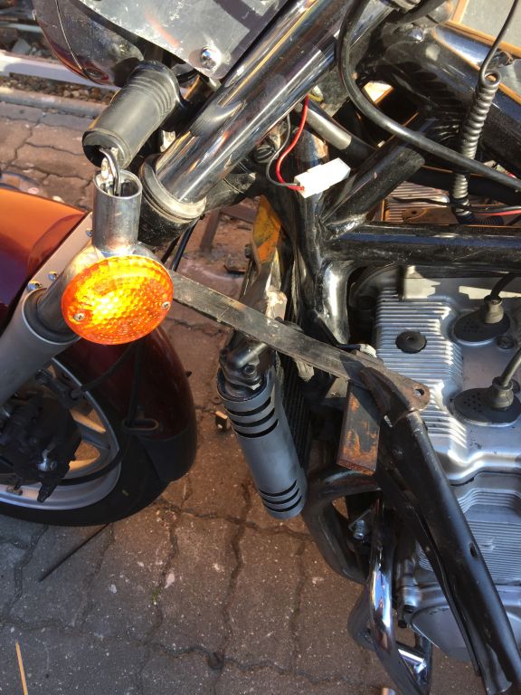

    Welding day today....working on the brackets...looking good.
    Fairing will be in a quite steep angle - but it looks good.
    And I could purchase a cycle sound....next step after having the fairing mounted.
    Dieter

  10. dieter
    dieter Learning the Ropes
    Jun 21, 2017
    32
    7
    Bavaria/Germany

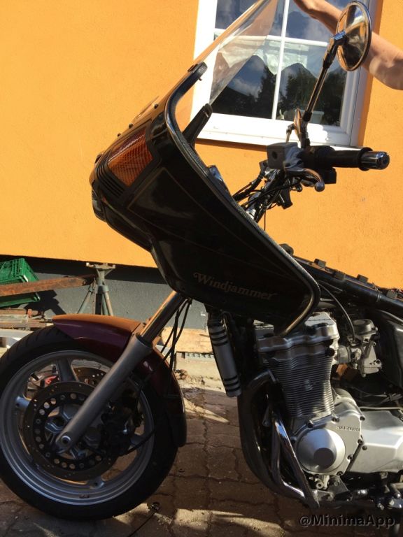

    Bracket is ready - Windjammer fits. Now painting of bracket, electrical installation, lowers and cycle sound 20170714_190549448_iOS.jpg

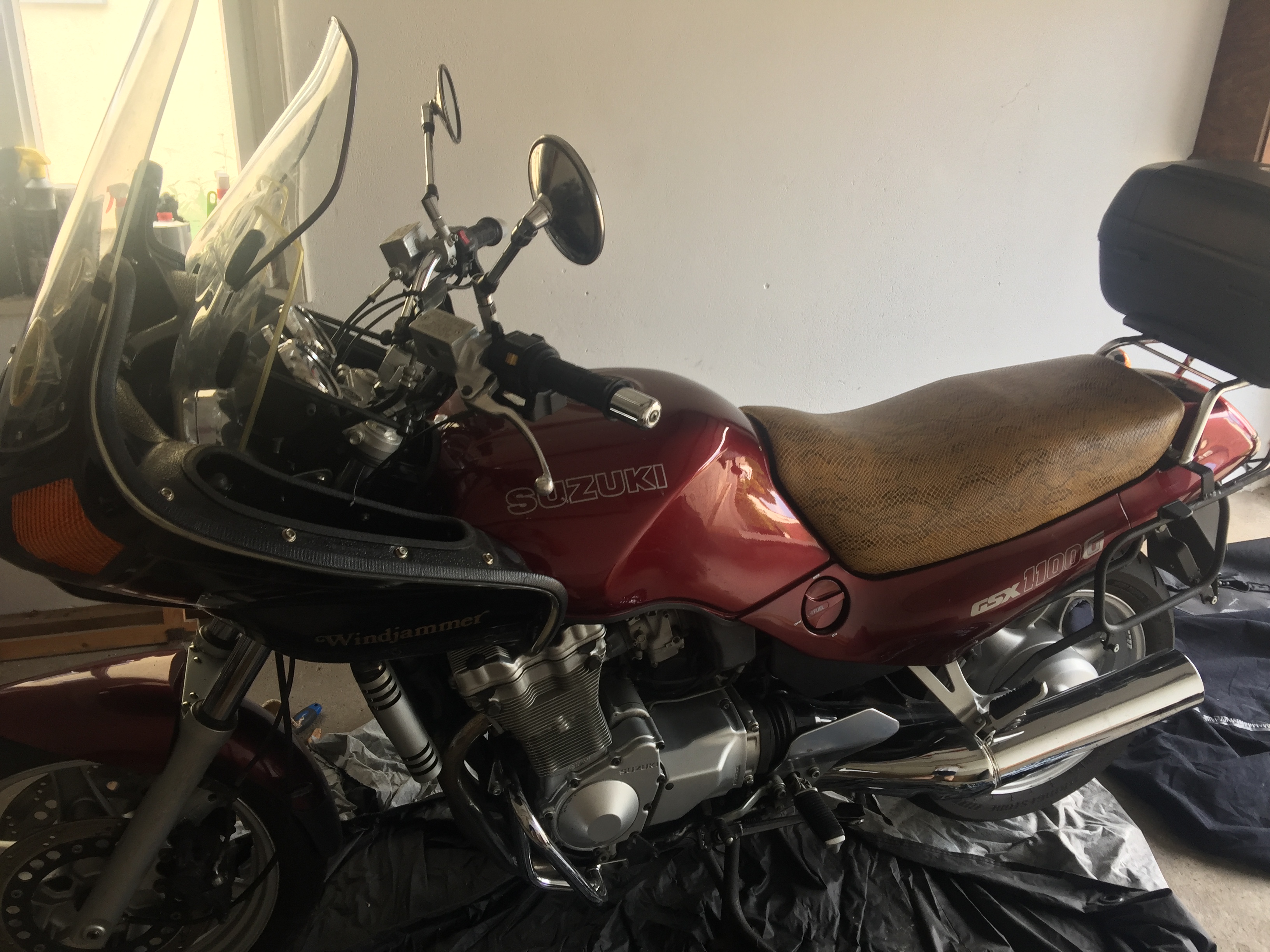

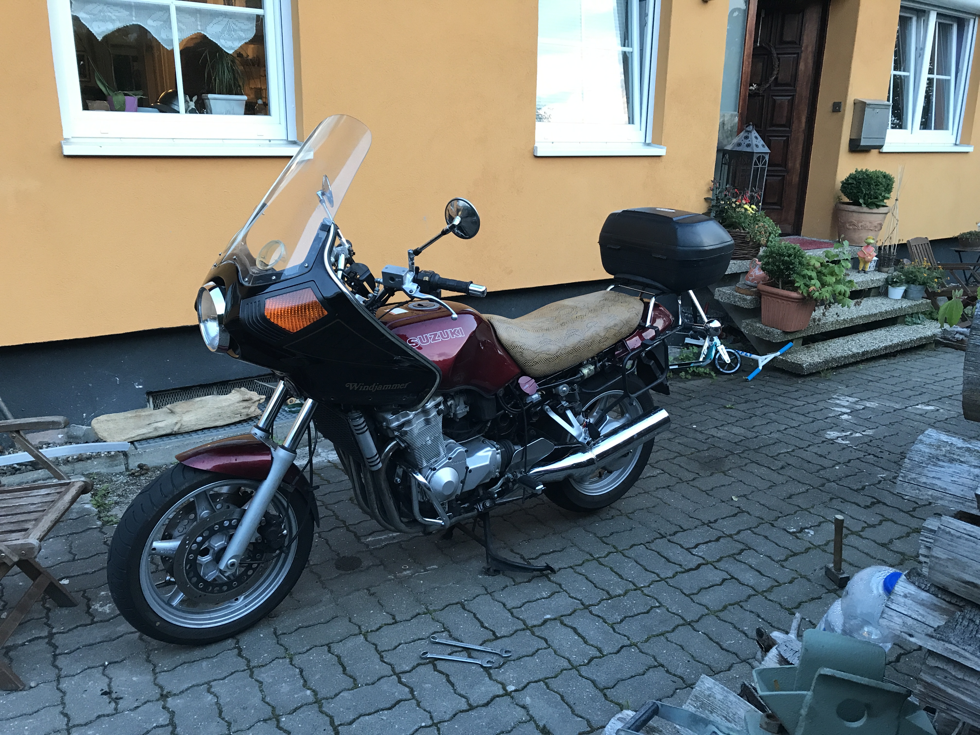

    Hello guys,
    last weekend I got the WJ4 mounted on my bike. Just some minor issues to be done like new horns, better adjustment, modifying electrical circuits.
    SN is 37-494270
    Vetter plug became replaced by a 12 pin Deutsch connector, headlight power now switched by 12V relais.
    Had the first ride of about 150km yesterday - great!
    But need to cut the windscreen by about 5-10cm (2-4in).
    Could anybody give me some idea how to cut the windscreen best?
    Dieter

  13. Scott-E
    Scott-E Vetter Aficionado
    225
    94
    Tape it both sides with masking tape to prevent scratching it and it allows marking a cut line. A band saw is the best tool for cutting it. A jig saw will also work but extreme care must be taken when cutting as the blade can become hot and melt the plastic, which will cause problems and more work dressing up the cut line. The reason for that is a band saw blade is much larger and so dissipates the heat rapidly. The jig saw blade is tiny and heats up on both strokes. If you do not have a band saw drop by a woodworking shop and ask if they will trim your shield. Have it taped and ready to go when you ask. Most Glass shops sell Lexan and have will have a band saw for cutting it. For a few bucks they will be happy to cut your shield and dress up the edge on a belt sander.

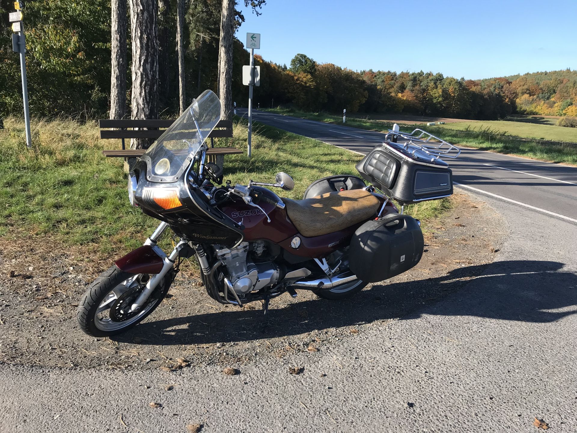

    Did the first 2000km with the fairing - have already been at the North Pole;) - great riding.
    Passed the technical examination - and now my bike is totally legal for Germany:rad

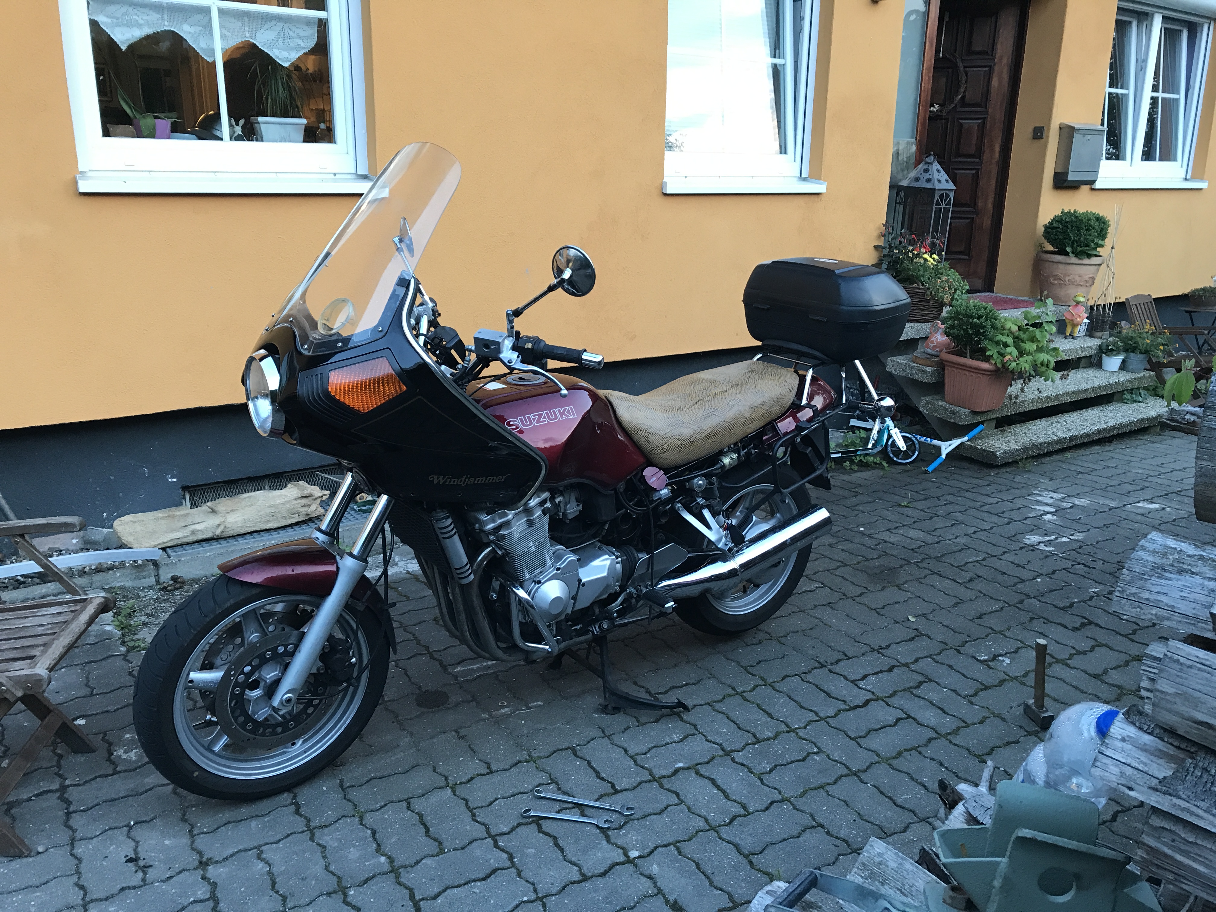

    Got the trunk....

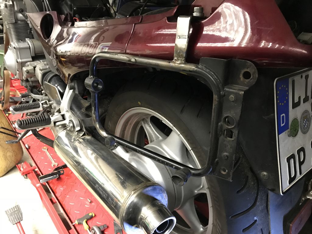

    And the saddle bags are mine....
    One bag needs to be repaired or replaced - then the bike will get a new colour - a fresh and friendy black finish :D
