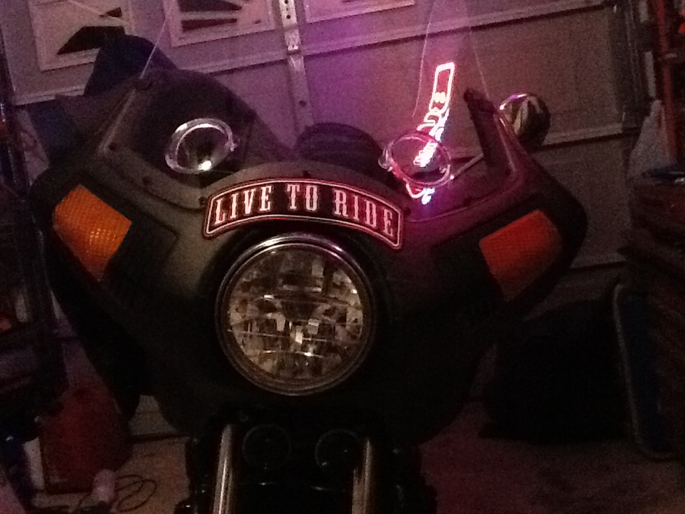

    I just purchased this; Truck-Lite 7'' Round LED Headlamp, Complex Reflector Optics Design
    from http://www.levineautoparts.com/trucklite-27270c-7-inch-headlamp-led.html
    Fired it up in the garage and it has very good "daytime" light. I can't figure out why i have a little flicker when it's on high beam at idle.
    Will try tonight to ride out on some of the back roads to adjust the height and see how much better it is. A little spendy but it's a mount and go application and it looks good on the bike.

    The head light in the fairing....
    [​IMG]
    [​IMG]
    From the end of my driveway @ 54'.
    [​IMG]
    The third picture is with the light on low beam and I'm standing back at the beginning of my driveway @ 54'. The light stretches across the entire front of the house. Makes it great for those rides on the country roads with minimal street lights as it more than covers the shoulders of both sides of the road.
    Seems to work with the headlight warning light. I still have that slight glow of the light on the dash. I do have a slight flicker when on high beam at idle. Checked all connections and can't seem to track it down.
    Tuesday night I rode out to the City Hall Saloon in Cumberland, WA. About a thirty minute drive from Kent with half of it thru the back country between Kent and Enumclaw. Nobody flashed their high beam at me the entire trip, either in town or on the back-road. I can deal with the flicker at idle since I normally don't sit behind someone with my high beam on at a stop light. At highway speeds it goes away.
    No regrets at all on this one for me. This is what I have been looking for for some time now. It is spendy but I feel I gain that back with the better visibility at night.
    Dan

    I used the factory head light from my 2014 CB1100. A little rigging but it is in there tight and secure.
  20. AVetterXS
    1,979
    Bear Valley Springs, CA
    Look like it fits pretty darn good.
