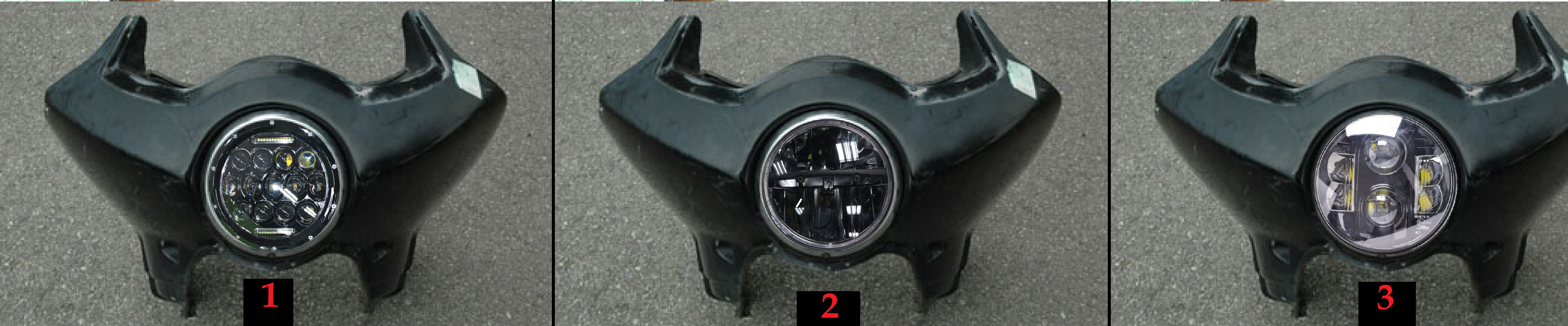

    which one of these headlights do you guys like best?

    Its a toss up between 1 and 2 if my opinion. I think I would settle more towards 1.

    I'm kind of torn between the three, but I'm leaning towards1 or 2
