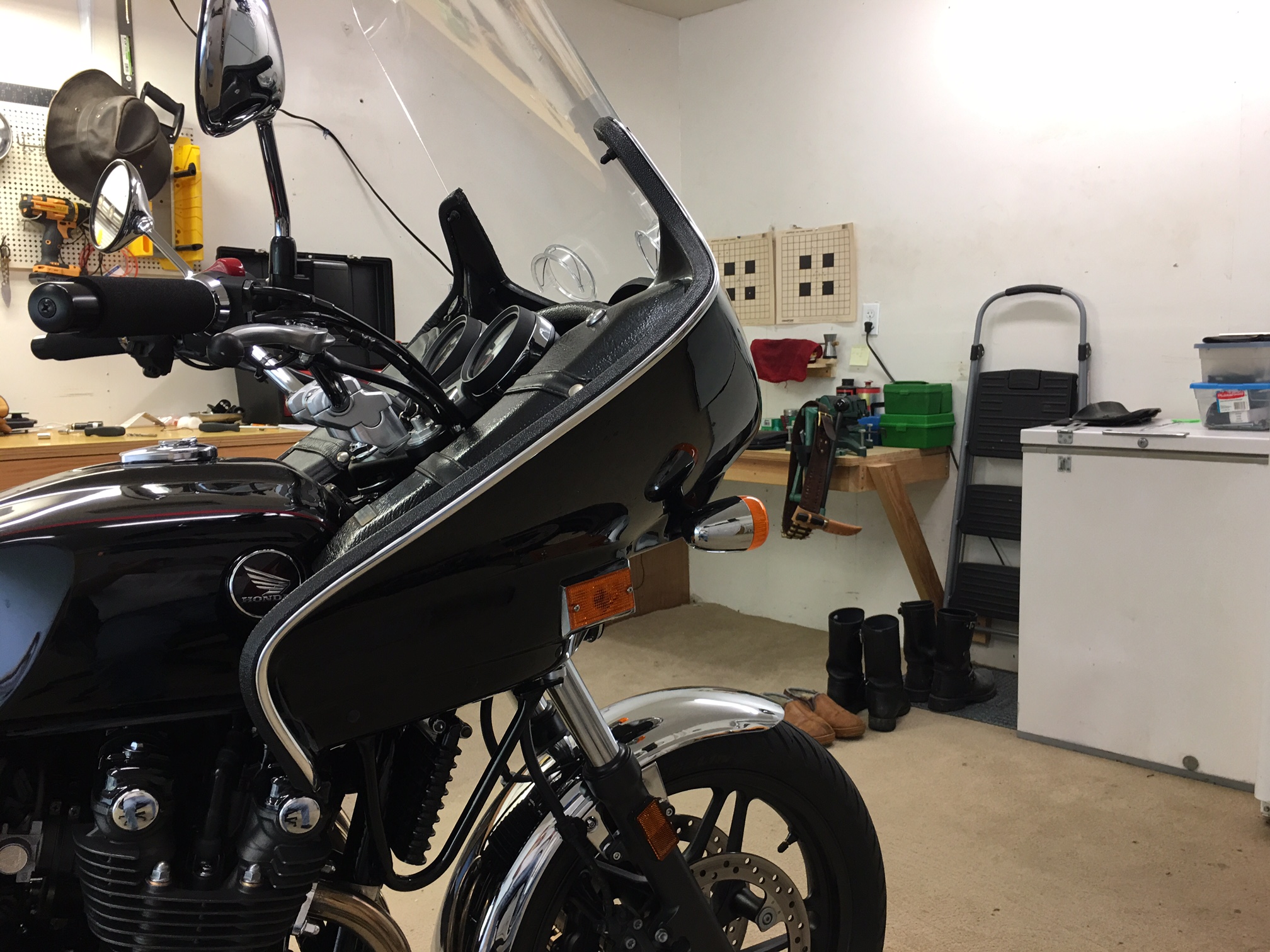

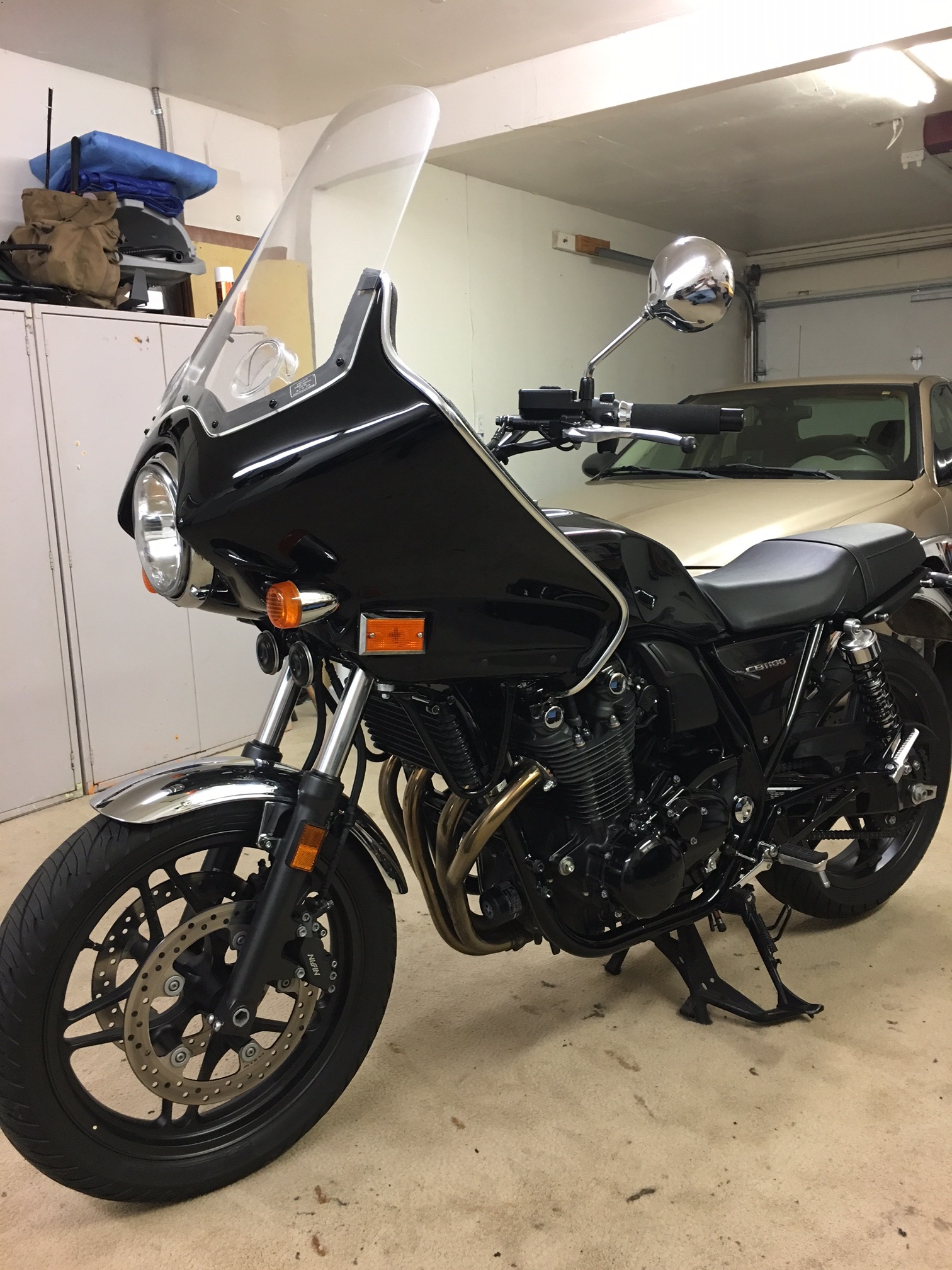

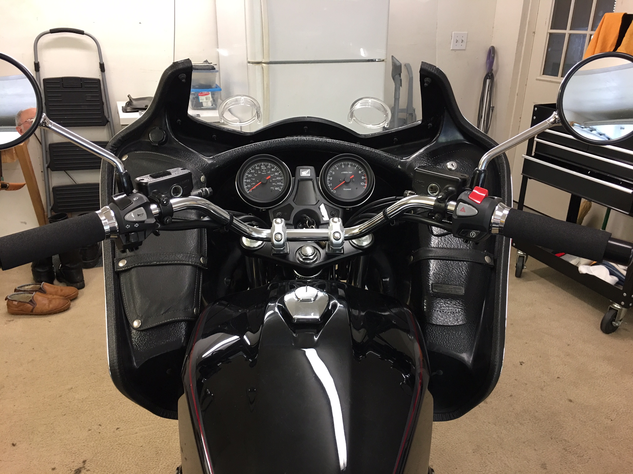

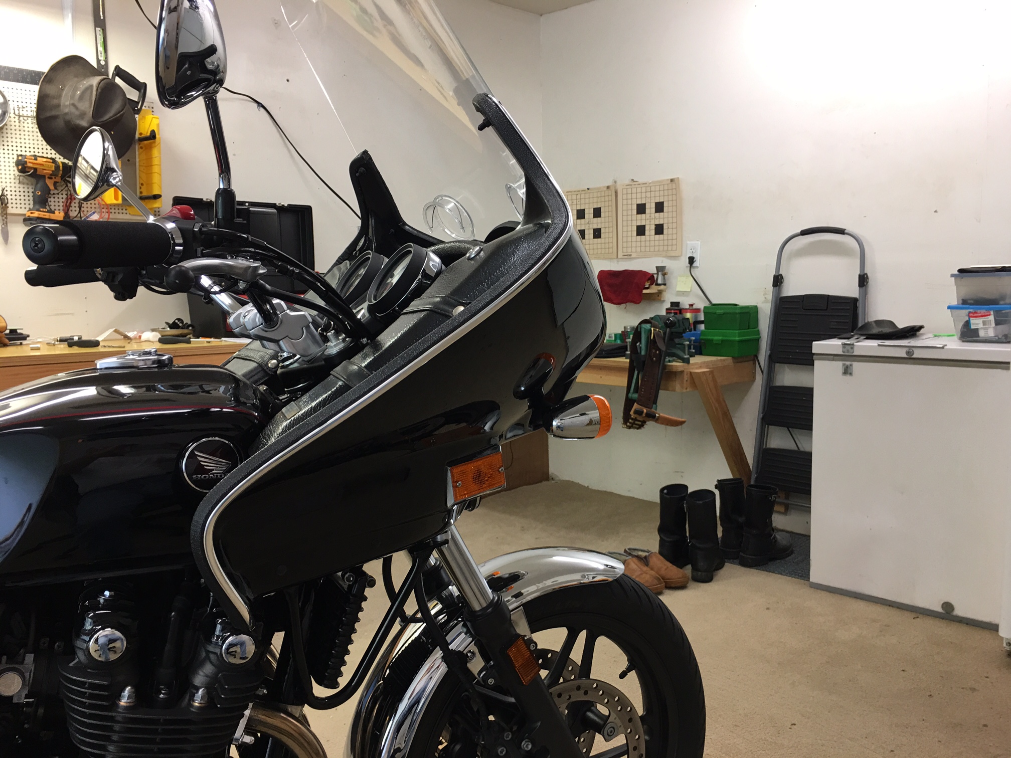

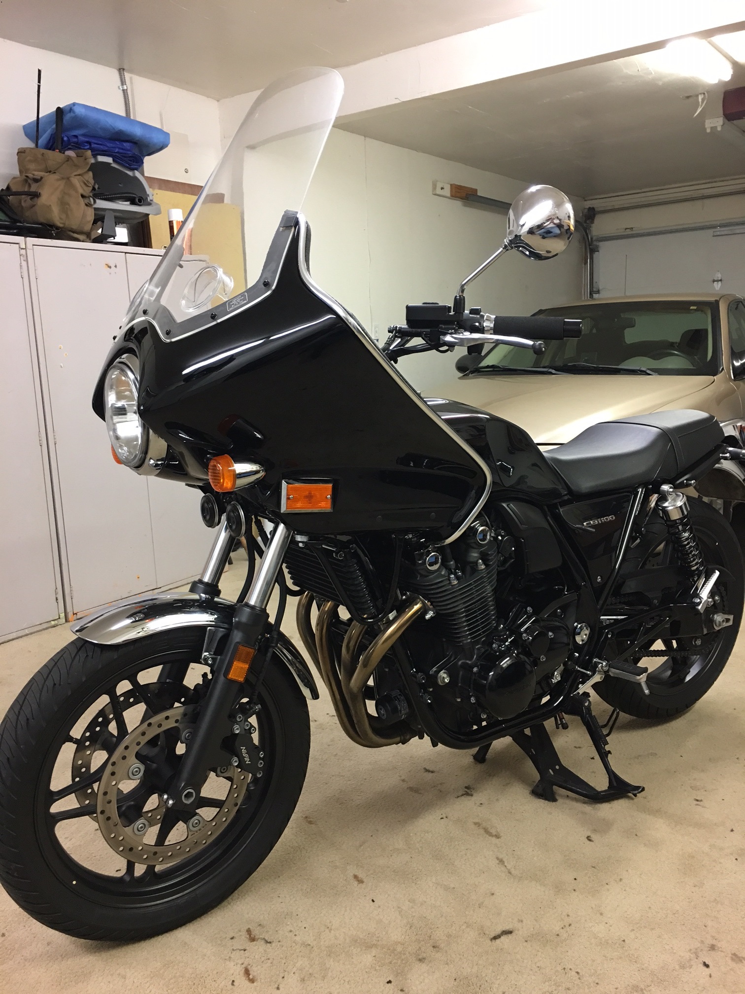

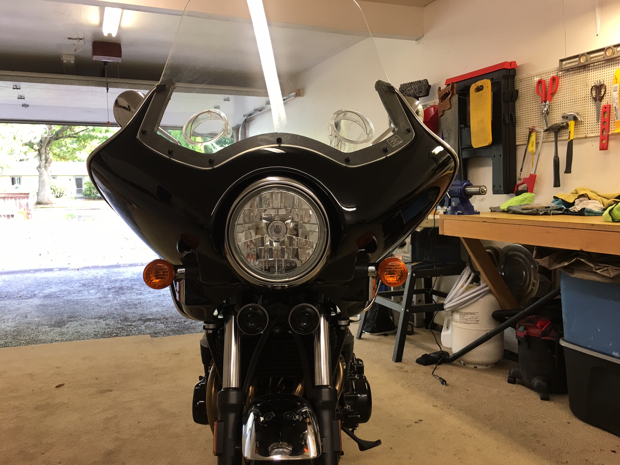

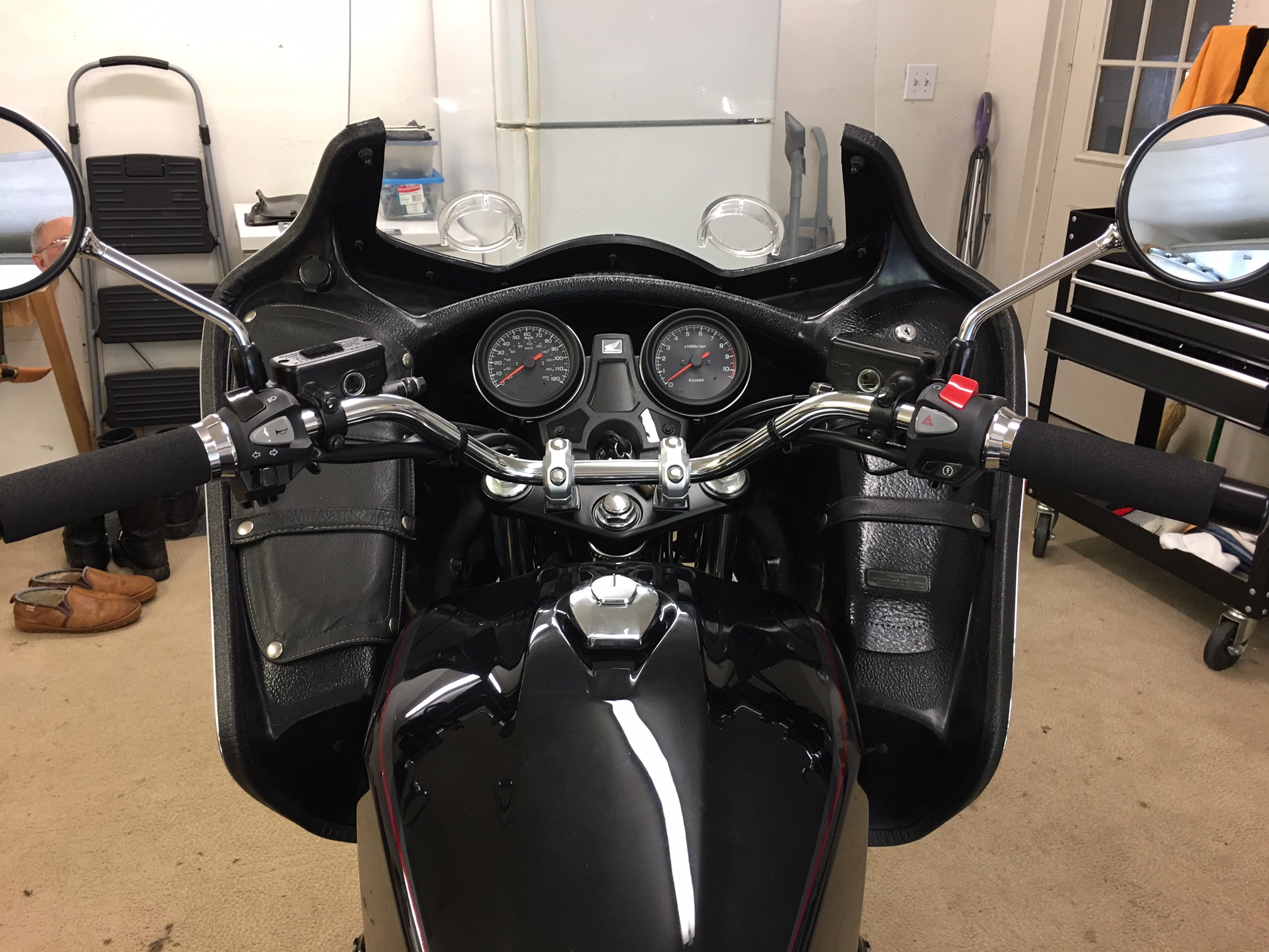

    I have the jammer III on the bike and it is finished. I haven't put any graphics on it yet. I'm kind of liken it without graphics. When all this nasty rain and wind quits I will get some pics outside meanwhile here are four in the garage.
    That Adjure ice headlight works like a champ.
    Damn sorry about that last pic. I don't have clue on how to fix it. (Think I got it, roncar.)
    Kevin

    :radThanks roncar that looks better.
    Kevin

  14. brianinpa
    1,295
    466
    How do you like that headlight?
  15. husky385
    husky385 Learning the Ropes
    Nov 10, 2015
    40
    15
    Eugene Oregon
    I like it way better than the lights that normally work in the fairing aka sealed beam bulbs.
    The wide beam allows you to better see both sides of the road.
    Seems brighter than the sealed beam bulbs to.
    The only modification you need to do to make it work is to enlarge the hole in the back of the bucket.
    Looking at it fitted I believe it could be changed to a LED bulb if you so choose.
    Kevin
