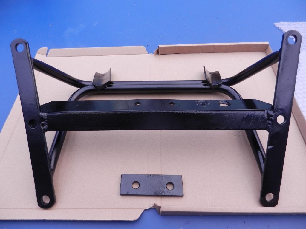

    Hi
    This is the one I have made for my Z1000ST so will be similar, its a Windjammer mount with Rickman top bars welded onto it so the frame mounting points should help, if you can find a Rickman mount easier where you are you could drill the WJ to accept the front mounting points, the back ones are the same. The 2 bolts in the middle of the second picture attach to a bracket that clamps behind the frame of the bike the last picture is the welded frame painted and shows this plate, hope this helps.
