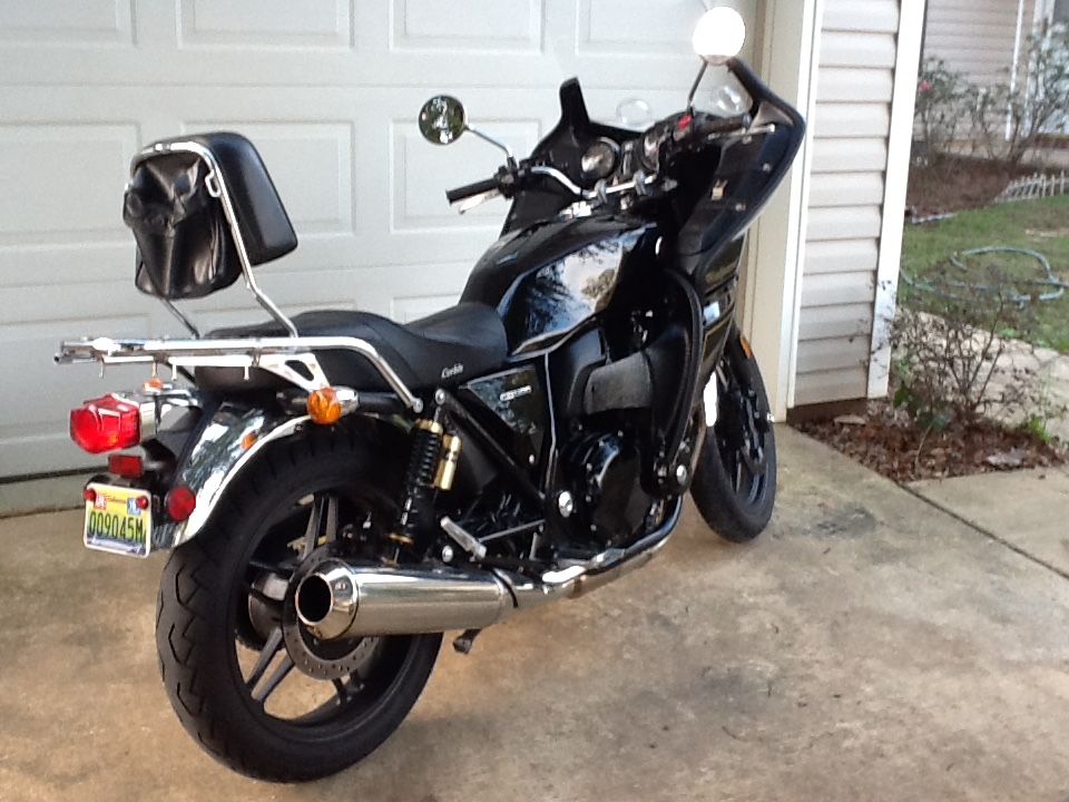

That is so cool! I tried to fit mine with a XS1100 Bracket. Had to cut it in half and try to fit one side at a time. The fairing was hitting the forks when the wheel was turned so I figured it wouldn't work But we were trying to hold it in place while checking this. Maybe we had the inside of the fairing to close to the instrument cluster on the bike.
You Sir are evidently a genius. Would like to pick your brain on your install if that's ok. Thank you Rick
Carguy1959
Oct 1, 2015
19
59
#12
The bracket I used looks like ones I have seen listed on eBay for a early 80's gl1000/gl1100. I didn't have to modify it much. I removed the oil cooler (temporarly) and test fitted it with large tye raps. The frame brackets were very close to fitting. I worked on mounting the bracket first, them the fairing to it. My gauges just touch the area where the pockets are on the fairing. I removed the metal cups on them to make a better fit. I did have to notch the bracket where the forks hit. The fairing itself was not in great shape so I covered it in marine grade vinyl.
