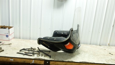

I bought the Windjammer IV and the seller had two sets of mounts that are just like the mounts in this eBay listing for WJ IV and mounts from a 1981 Moto Guzzi Convert.
Here is a photo of the mounts that are like the ones that were with my Windjammer.
The number stamped on one of the Vetter marked single bar mounts is 150160023; there is a scrunched up yellow sticker on the other one with some numbers written in ink that appear to begin with 5222 and end with -78 but I can’t read all of them. These appear to be designed to mount to the top of a set of crash bars, but the bars on my 96 are lower than the cylinder heads so these mounts would be too low; they are also for a smaller diameter bar than my 1 inch diameter crash bars.
The frame mounts have no numbers that I can find. A quick fit-up indicated they might work on my 96 but I have to wait for the rain to pass to get a better idea. The question I’ve asked the Guzzi folks is whether the 96 California frame is the same as an 80s V1000 frame and I haven’t found the answer to that yet.
I find it interesting that Vetter would supply two sets of mounts for a Moto Guzzi. Maybe one for a Guzzi with "safety" bars and another for those without? The seller of my Windjammer said he originally ordered the fairing with Guzzi Mounts for his V1000 Convert and then ordered mounts for a Honda later and I thought one of these sets might be for the Honda, but the eBay listing has both sets too.
