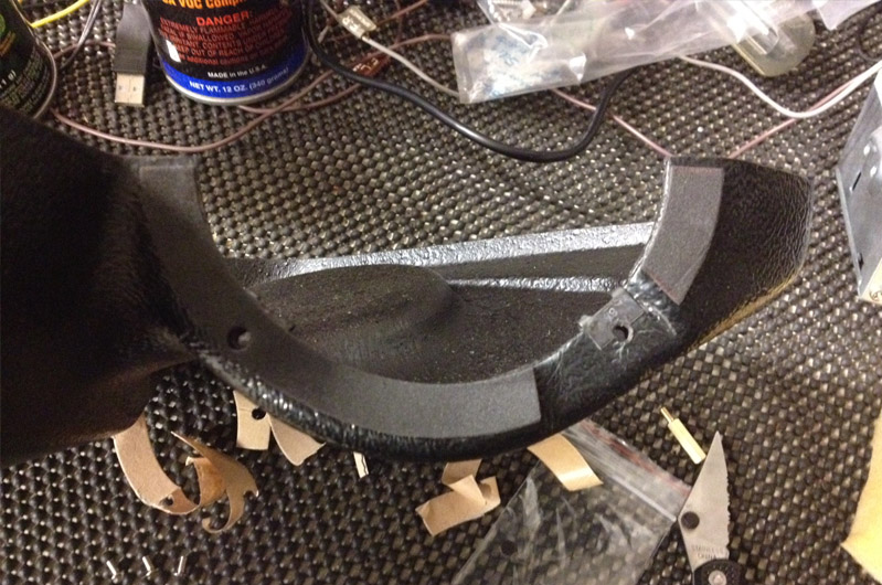

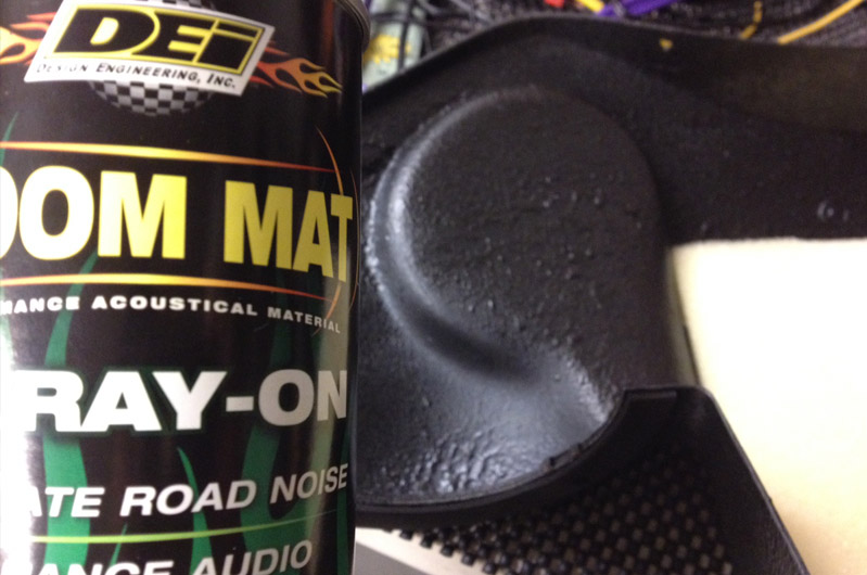

Used Boom Mat to spray coat the inside to give it some damping.

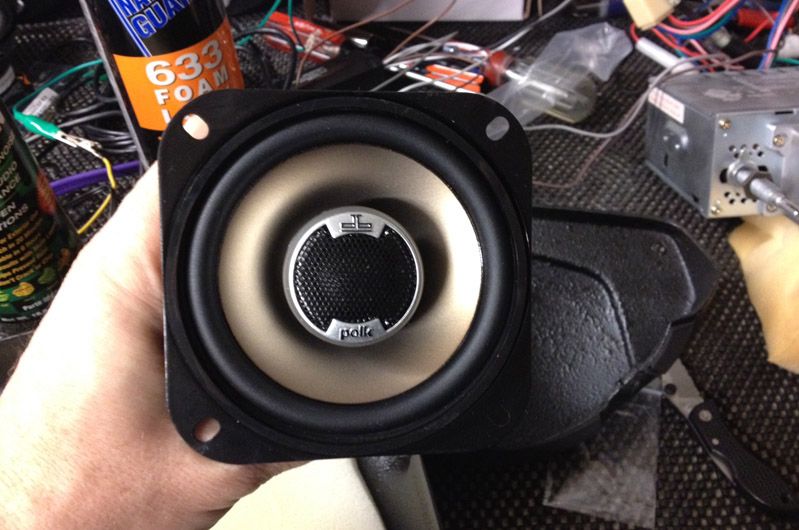

Using foam gaskets around each driver
Polk Audio marine grade 4" speakers. These are very affordable and sound great, specially tuned for the enclosure.

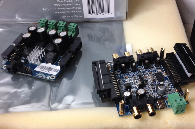

A computer controlled DSP to calibrate the audio to sound perfect within the Cycle Sound enclosure. I will tune the speakers and enclosure with a 24 band software based EQ, and save the preset in the DSP. From there the signal will be delivered to the small amp you see below. DSP on the right and amp on the left.
