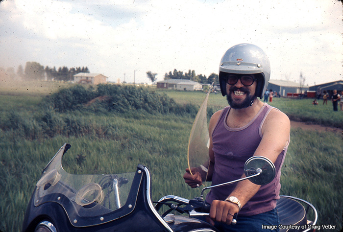

Loyal snapped the windshield, just the way Larry said.
We had problem to solve... Fast forward thru more than 3 years of problem solving:
In every case the windshield breaking, we learned that it cracked from top hole to top hole. Just like in the above picture. Holes weaken the material. Holes at a high stress area at the top weakened the windshield at the wrong place. The solution would be to not drill those two top holes.

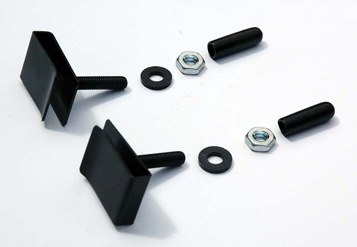

To that end, I invented Windshield Clips:
It took several years to develop, test and perfect but when we were done, windshields did not snap anymore.
Beginning in February, 1977, we stopped drilling the top two holes and supplied Windshield Clips for all windshields. The great thing about this solution was that a new replacement windshield with clips would fit the first Windjammer made in 1971.
Replacement windshield sales dropped to almost nothing.​
See US Patent # 4,087,110
