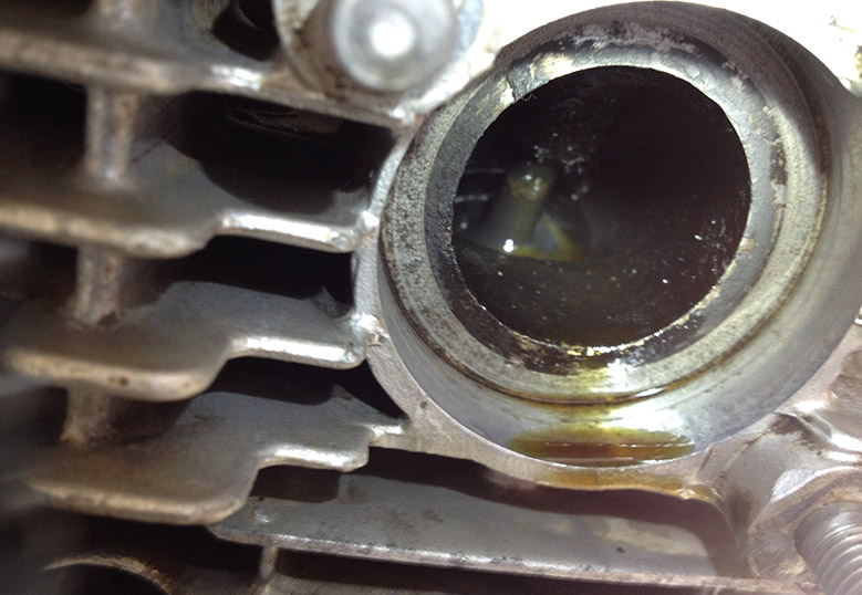

I noticed that at times it would leak oil off the number 1 cylinder exhaust flange bolt. I looked and looked and could not find out where the oil was coming from. It was not the cam chain tensioner gasket, head gasket, valve cover gasket, or traveling from somewhere else on the top end. After being driven nuts by this, I cleaned everything thing off and pulled the exhaust pipe.

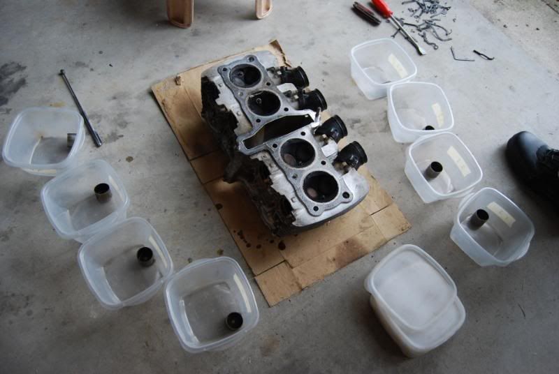

and there it be, a puddle of oil siting on top of the exhaust valve. So bad valve seal or guide, my knowledge starts to diminish here. So, what it was doing was sometimes when the valve was open, the oil would just run into the cylinder causing lots of smoke on start. Other times the valve was closed, and it pulled up on the valve and ran out the flange onto the floor. So, I removed the head, and it sits in my trunk, ready to go get fixed up by my bike mechanic/ machinist friend.
First, great to hear from you Steppen!
Second, that is the most interesting way I have seen to categorize your valve caps and shims.
Whats the back story on your XS11 head?

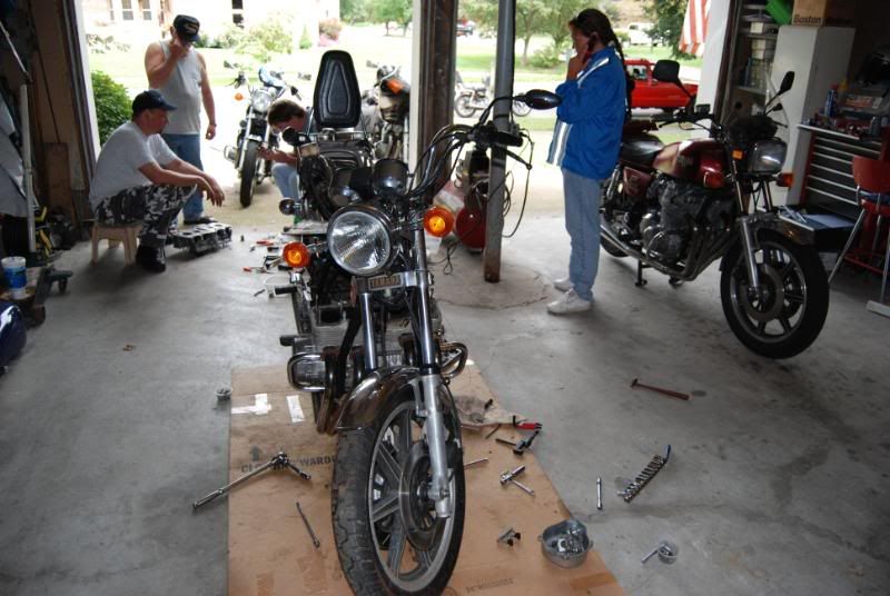

Well not my head.:)We used to have man cave days and work on XS's,up to 9 would show up,that was a barn find and it got a head that was sitting around and finally put back together running great and then 6 months later his garage caught on fire and it was destroyed.It happens.Have a picture of the bike somewhere.
We can pretty well do everything to theses bike to keep them on the road.

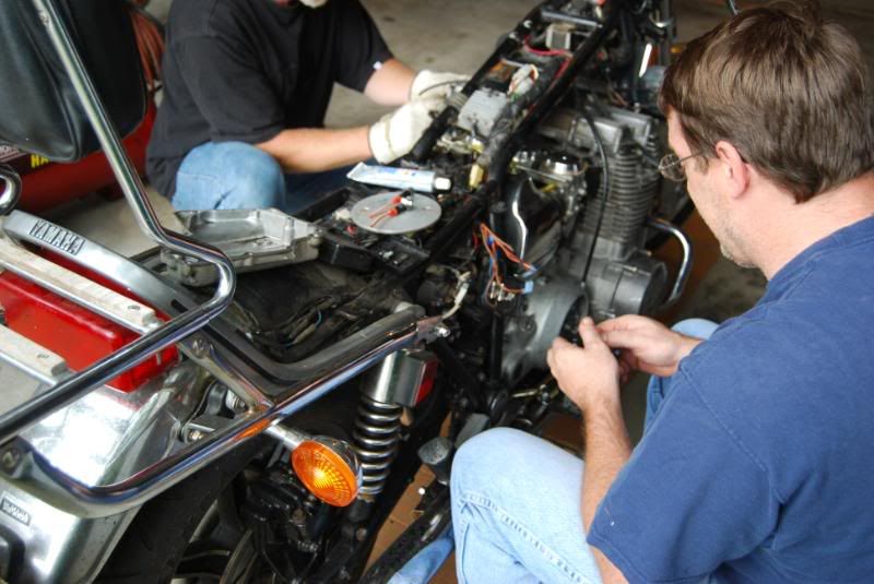

Lining up,think I got a new fuse box,glass to spade that day.

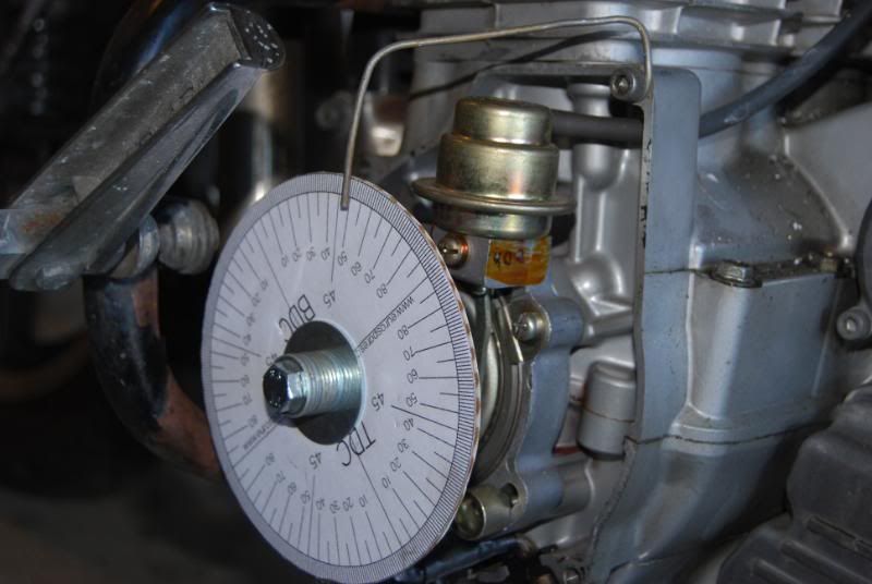

How about a homemade timing wheel.
