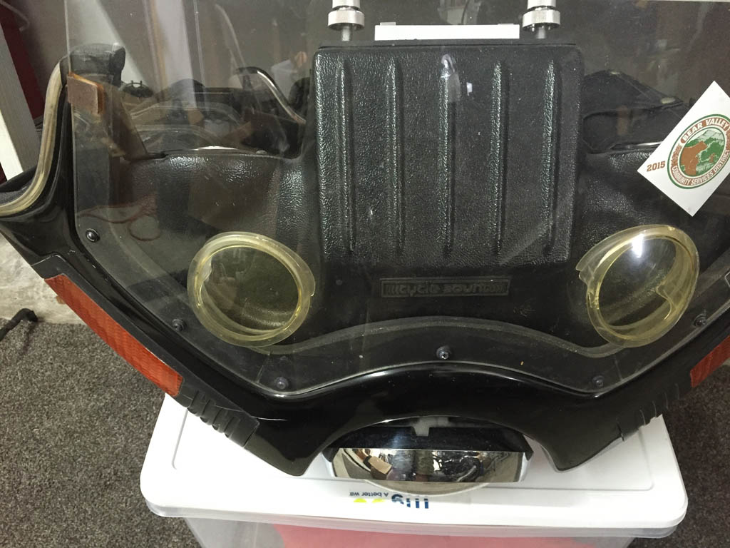

Ok, here are the pics. The Cyclesound doesn't fit correctly. If you stand it up it fits better but not quite right, and you have to drill holes in the top of the enclosure to fit the studs from the windshield.

Hard to tell from your pic, but I know there were several variations of the CycleSound/VetterSound for the Windjammer fairings. And at least one version that was for the Hondaline fairing that was way too big to fit in a Windjammer. Here is a comparison pic, VetterSound on top Hondaline on bottom.
Looks like I have the one on top, and I believe I need the Vetter. No matter where you put it, there is no way the metal brackets can be used and also it blocks the windshield vents

I don't think that they should interfere at all if you have the proper fitting stereo enclosure.

The one I got does not fit my WJ5 anywhere nearly that well. There is a large difference between the contours, and a large gap around the central arc above the headlight.
The speaker holes are 4-1/8" dia. It says "Vetter" on the top and has a yellow Vetter Sound warning label underside.
