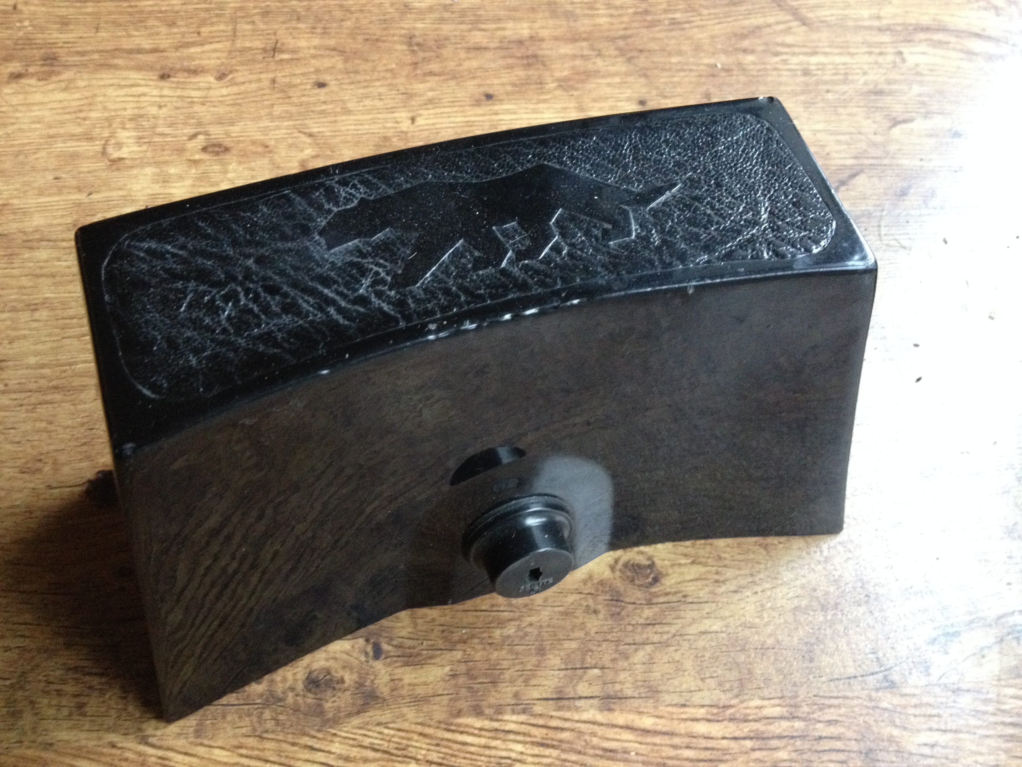

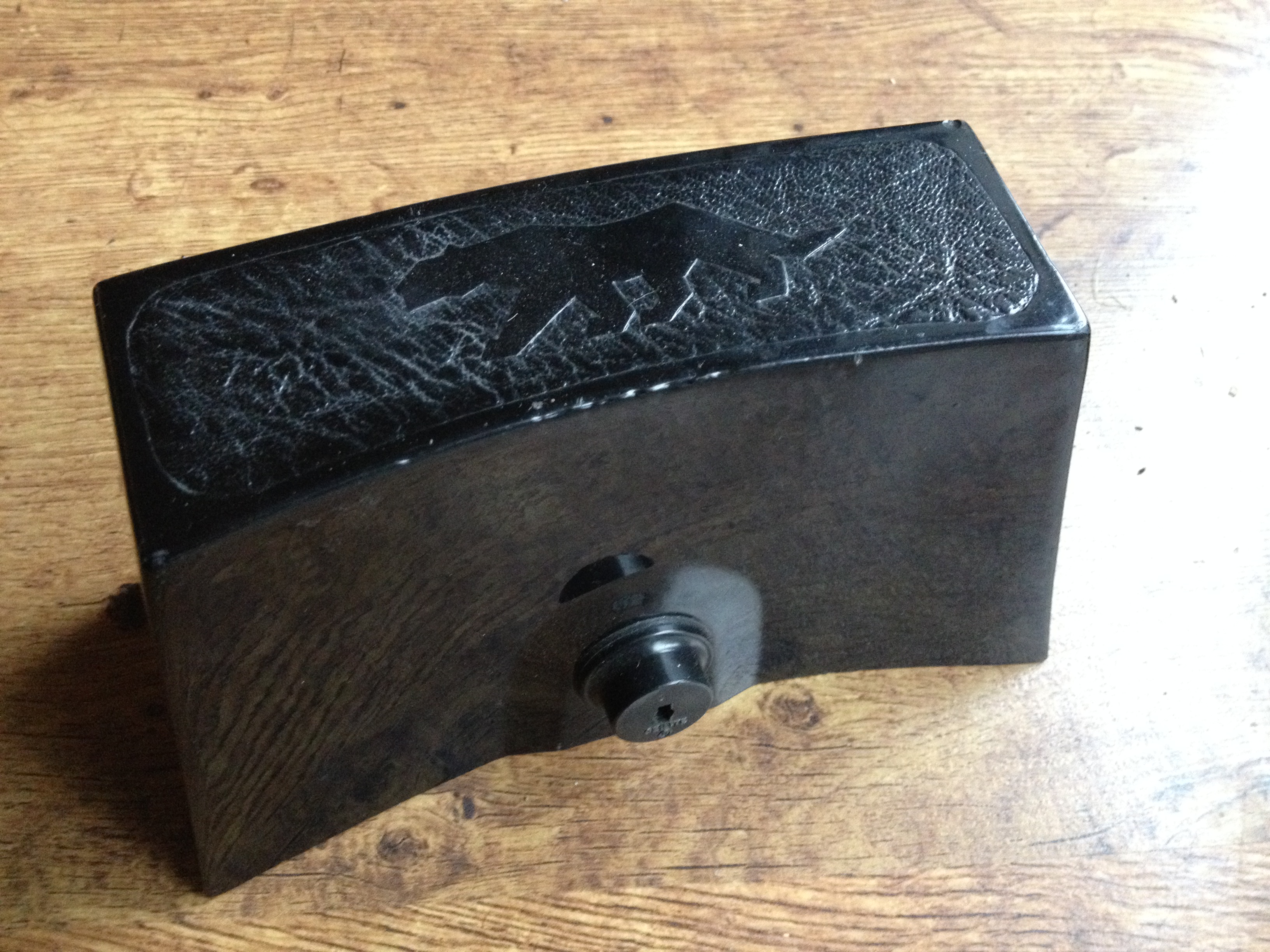

You mentioned about the radio hump in the fairing. This is the lockable cover that goes over the radio. I also paid for the manual headlight adjuster, which sat on the right hand side just below the side cover, and a pair of top class Cibie spot lights which were mounted just under the side light/indicators, mirrors. Looked the same as the despatch bike in an earlier post. Pantera also colour matched to the deep burgundy of my GL1100. All in all I seem to remember it costing about £500 - £600. The wiring connector is still available from RS electronics. Just bought a new one. A few repairs to be done where some theiving toe rag ripped the spot lights out in about 1990 but will soon be going back on my Goldwing which is now a trike. Will put a picture up when its done

Now, I didn't know about the radio cover. They'll be like hens' teeth nowadays though, but now I know what it looks like, I might spot something at an autojumble or ebay.
The other handy things are the instrument moulded blank spots - no need to buy an additional console for them.

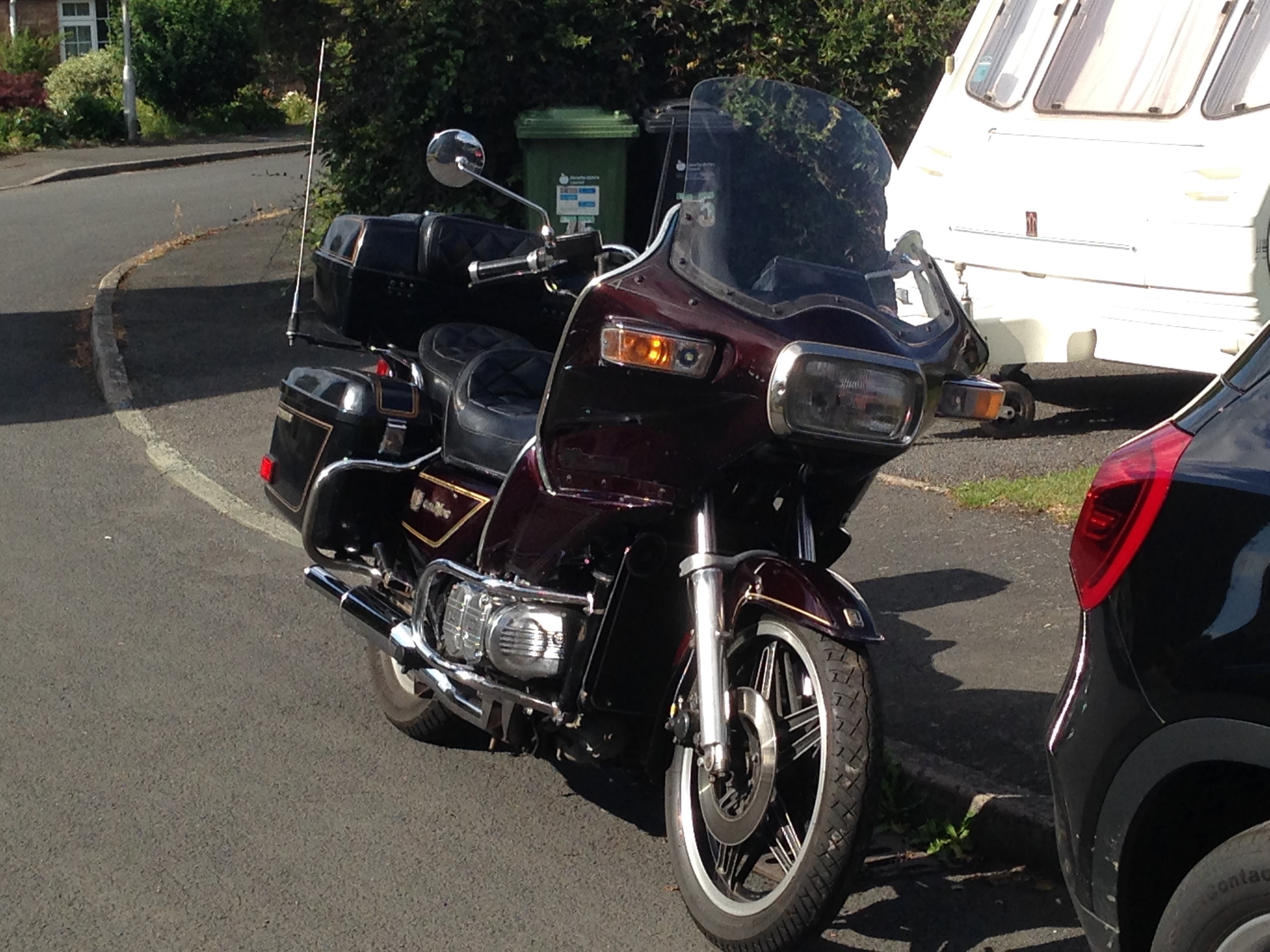

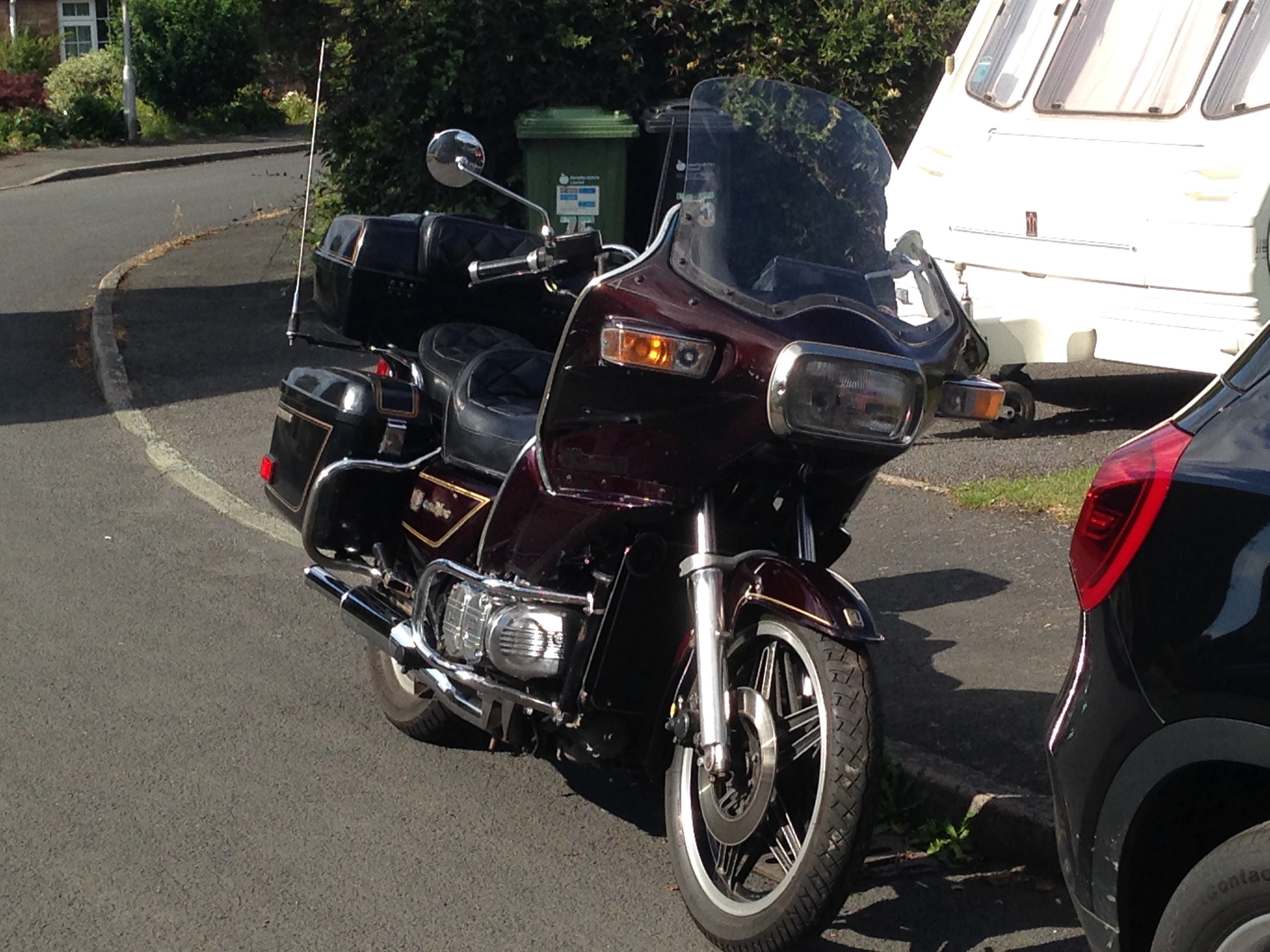

Finally took a photo of it at a trike rally last weekend. Forgot to mention it has a headlight adjuster on the lower right panel of the console. Looks quite smart if I do say so myself :)

Finally took a photo of it at a trike rally last weekend. Forgot to mention it has a headlight adjuster on the lower right panel of the console. Looks quite smart if I do say so myself :)View attachment 2180
That's very nice, indeed.

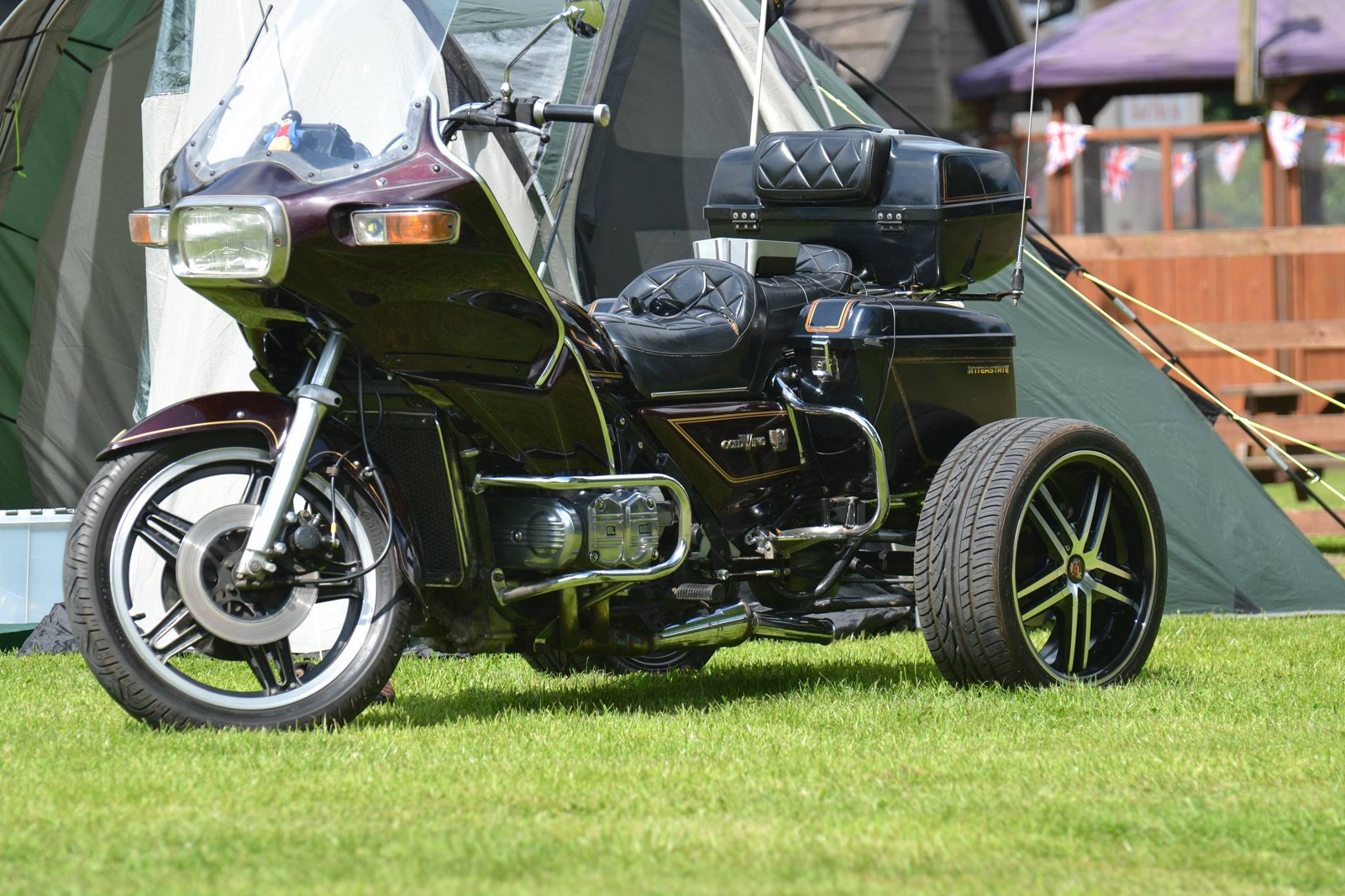

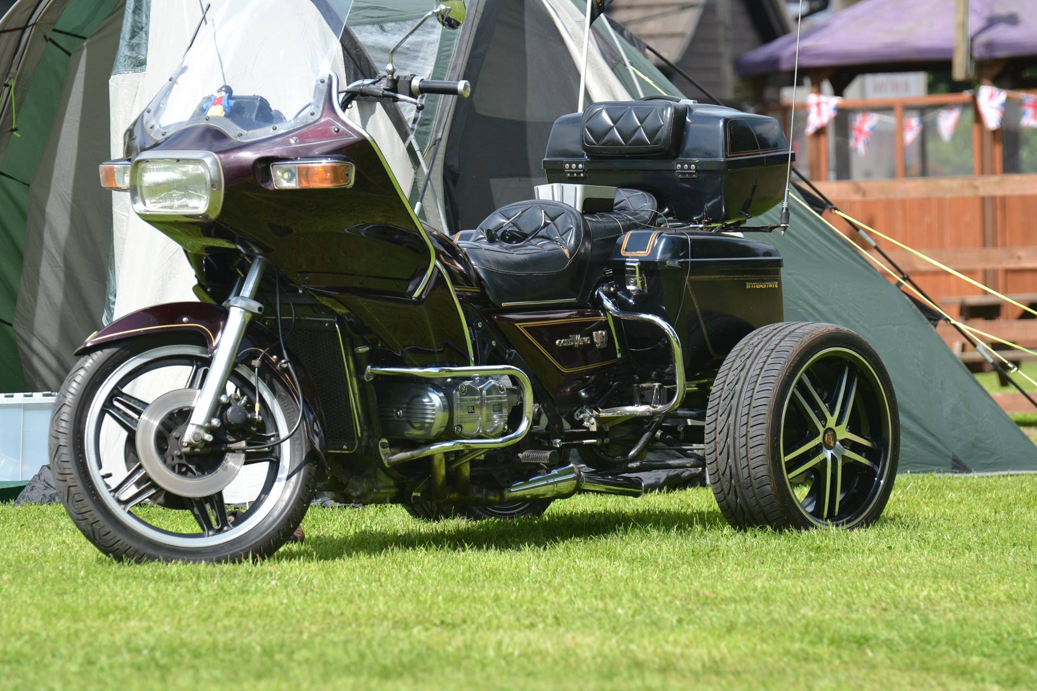

Now converted back to a solo with an LED headlight conversion and LED marker lights in the fairing. Toured France towing a trailer with in in October 2017. :)
Right, that's a very appealing combination.
