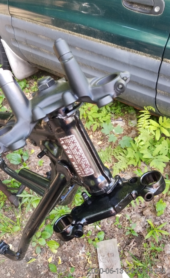

I painted the frame today. This evening it dawned on me that I've only had the bike for four days.

Spent some time on this project yesterday and today. Painted the upper and lower triples Friday night, installed tapered roller steering bearings and built up and installed the forks too.
It's a roller with the addition of those rusty wheels.
